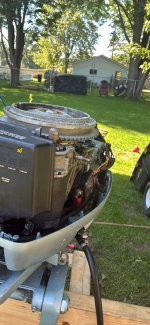

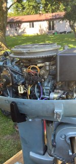

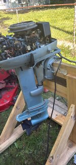

Hello I’m 15 years old and I bought a 1981 evinrude 35 hp electric start for $150. Compression readings are 115-120 and it has spark. Previous owner cut the controls so I’ve been jumping the starter. The ground wire for the solenoid is bad. Just curious as to what my next steps would be. Looking to sell it once I get it running. Any advice is welcome I just don’t know where I should go from here. Thanks for taking a look at it!

I've restored a bunch of those...for some reason I had to redo the wiring harness on the motor...wires rot out. Peel back some of the tape and look at the condition of the wires. Compression is good, now do a spark gap test...looking for a 3/8 gap test. Easy to sink to much money into these old gals when trying to make a profit. Max Rules Evinrude wiring layout for how to make a harness. Good luck.

Someone has already been messing in there and has shortened One Wire too much. Love the Mess on the Hot Solenoid Terminal.
The One Red wire, looks like it had gotten shorted to ground, got Hot, and melted the Insulation, since there there are other wires in the Harness, their Insulation may also be melted and may have also shorted, to each other, or to ground. At least you need to exam all wires in the Harness,
Correct me if I’m wrong but I believe that’s from rodent damage. I forgot to mention that there was an abandoned nest In it.

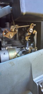

This is my 2nd post on here about my 1981 4”35hp electric start. I’m looking for advice on what to do next.
Pros✅
Has spark and good compression. Compression #’s are 115-120.
Starter works.
Long shaft
Shifts through its gears
Freshly rebuilt carb
No leaks
Prop In good condition
New shift handle
Cons ❌
Ground wire to the solenoid is bad.
Choke doesn’t function properly (you can use a screwdriver to choke it by pushing on the butterfly)
Unsure if it runs but told by previous owner it did.
Knob to the idle adjustment needle broke.
Unsure if it pumps water
I haven’t gotten it to start but I’ve been jumping the starter.

Show us a video of you trying to start it. Knob is not nessesary really, how many turns out are you? Did you use OEM parts when rebuilding the carb? Install a new ground wire...is the neutral switch working correctly? Electric choke moving?
Answers these questions and we can see what we can offer.

I’m 3 ish turns out I counted the turns when I removed it and that’s where it was at. These don’t come with an electric choke it has a manual. The carb was rebuilt by previous owner but I was just inside of it the other day and I didn’t see anything out of order. I had it in neutral when I was jumping the starter but I switched to wrapping a cord around the flywheel because it was a little too much sparks for my liking. I haven’t even gotten to the solenoid wire yet but it’s very obviously corroded and bad.

Electric start typically has an electric choke, must be a tiller. If you have any sparks you should fix that.
Carb should be 1 1/2 turns out from lightly seated. Any more than a quarter turn either way typically means something's wrong.

the 1981 doesn’t electric start doesn’t have a electric choke I don’t know why Johnson/evinrude decided to do it that way on the 35hp but there is no spot for an electric choke.

The Rope Start Motor, only had the Manual Choke, unless the Electric Start Accessory Kit was added later. Electric Start Models came with the Electric Choke but still retained the Manual Choke, though I don't think they came with a Recoil Starter.
