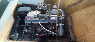

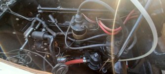

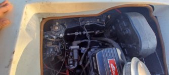

Hello, I'm hoping someone can help me cause I look up serial numbers on this 1979 Renken Runabout and I can't seem to find any information on the motor and drive shaft!!! IDK much about boats but the drive shaft? Last part of motor with Prop, serial # 5357241. Can't find any info on motor neither, serial # 5349030 Mercruiser 120. Also I haven't looked up hull yet but serial # RBMEM538M71. Thank you and please help me!!! Lol
Just hoping someone can't point me in the right direction...

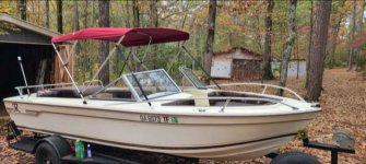

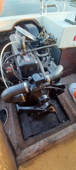

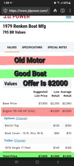

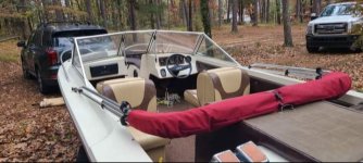

Do you know if this is a good boat and motor? Does it have alot of problems? Guy let it sit with 20 gallons of gas and it for 1.5 years and wouldn't start. Says his mechanic gonna rebuild carb and will be good? I offered $3000 but now I'm thinking $2000 because on NADA GUIDES.

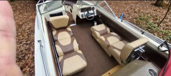

Sorry for all the replies but trying to get this all figured out... For More background it has new floor 2019 and new jumper seats 2020.

Boats like everything else, they sell for what the buyer is willing to pay. If you like it it's worth more then if ya don't

the floor is the last thing to rot
check if they simply threw the new floor over the old floor. if so, walk away.
Its called a deck-over
since the ski locker is no longer there, I am going to guess this is a deck-over
based on these two pictures, I assume its a deck-over
ski locker missing (nearly all boats from that era had a ski locker)
screenshot_20230621_130600_facebook-jpg.382383
looks like two different layers of flooring under the carpet
20230622_192242-jpg.382387

Thank you again!!! I asked about ski storage but said there was none... I think I will pass, thanks so much for your help.
