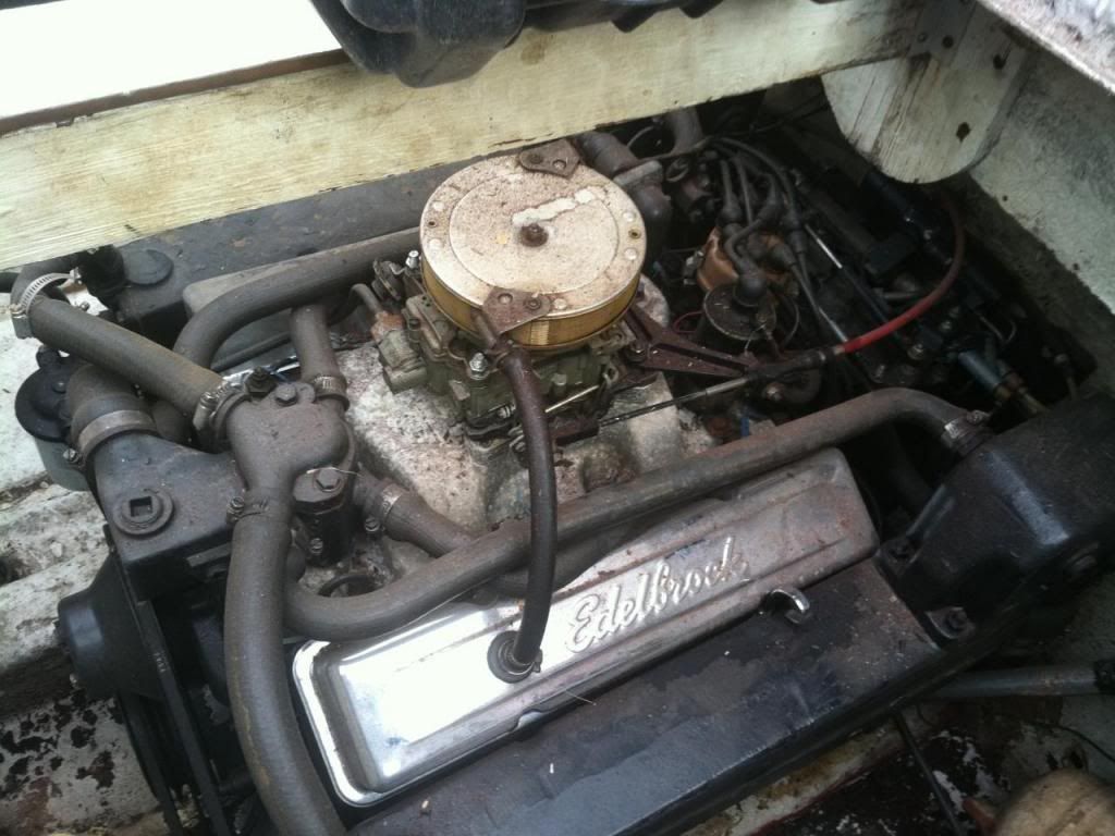

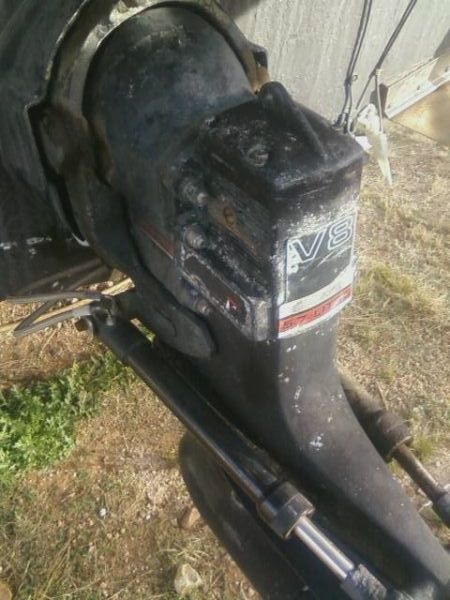

I am planning to buy this boat. I've been doing some research and the feasibility of doing this as a project.
Before jumping in, can someone ID this engine and outdrive?

Ayuh,... Sure looks like an MC-1 drive, 'n if it's a 350, it'll be a 260 hp, the 228 was the 305 with a 4bbl. carb...

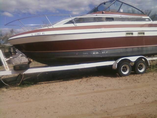

Thanks guys for the inputs. I just found out that the engine was a Chevy 350. It was replaced in 2002 as identified by tazrig.
And the last time they run the boat was 2yrs ago. The boat needs a lot of cosmetic work and I am not sure about the engine. Owner said it needs just the spark plugs change. But I am not sure about the condition of engine.
Here is the whole picture of the boat. What do you think is the right price for this boat?

based on what i see in the pictures, it needs more than "just plugs"
full tune-up, change fluids, pull n pressure test the drive, check alignment, check bellows, etc...
if you really want the boat have a reputable shop do a mechanical inspection

I'm thinking $2k maybe . . . Without seeing the interior.

Now the $6ooo,ooo question, what kind of shape are the stringers in? 9 chances out of 10 they are rotten! :eek:

the side windows leak in all the way to the transom so start tearing everything out and buy a lot of epoy resin cause its going to be a lot of work

That boat is worth no more than the gamble of how much the engine and drive are worth. So... I would say $1500-2500 tops.
