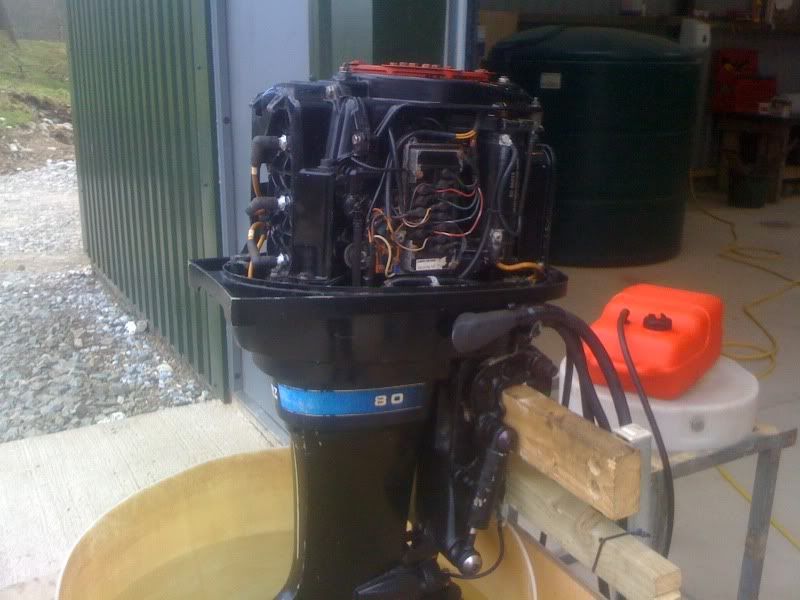

At the beginning of March myself and a pal came across a 1978 Searider 5.4 with a Merc 80 of the same vintage.
First job was to start on the outboard to see if it worked before setting upon the boat armed with a cutting disc and a bucket of gusto.
As the engine hadnt started in some 10-12 years the first job was replacing anything that might give us hassle, fuel pump, water pump, plugs, exhaust cover gaskets, carb to powerhead gaskets, carb rebuild, wirning replacement, new fuel and vacuum hoses and new fuel connectors both engine and tank side, theMercontrol unit was also treated to an overhaul including a new IGN barrel, battery leads and a repaint.

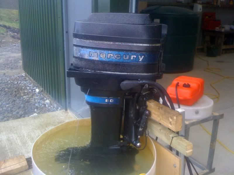

Tonight was the first proper start after ALL the work, we put it in a HUGE tub of water and turned the key.. nothing! It spun over but wouldnt fire, we tried several times but to no avail, we took the cowlings off to check for any visible problems but all looked good, we decided to give it one last go before digging deeper and BINGO! She fired right up and after a fiddle with the throttle she settled onto idle and sat there purring away lovely!
As its the first proper start we mixed up quite an oily mix and left it idling for 20 mins or so just to get everything inside up to temperature and give itself a clean out before lifting RPM, we will try a faster idle tomorrow. If im honest Ive never heard a 2 stroke idle so smoothly and very quiet for an old engine.

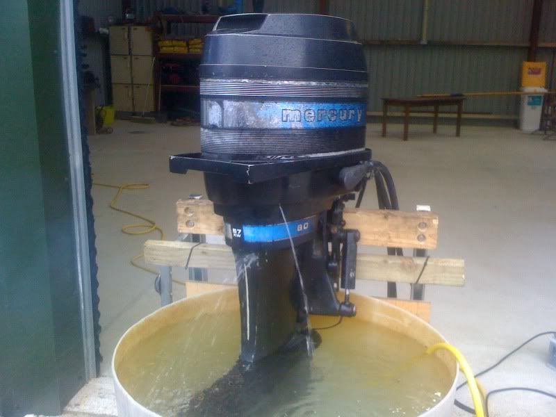

Today we tried it in gear, it was idling for 30 secs before I tried forward gear.... it stalled.
Another minute on idle and it slipped into forward and reverse gear with no issues... well not until I gave it too much gas and it tried to jump out the barrell and part company with the stand. Ive never had any dealings with bigger motors so wasnt aware they were quite so violent... anyway, thats my story and Im sticking to it!

Re: 1978 Mercury 80
Just an update...
Its trashed, crankshaft splines went after 1nm.
Now on ebay in several parts.
