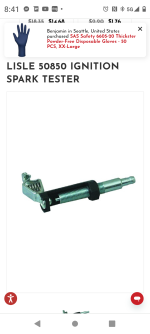

Picked up an inline spark tester and will test soon. What’s the name of this other device and I’ll order it along with new head gasket

What should I be looking for? Or what tool is actually going to be useful for this? I can test for spark but i guess I’m wondering how I test the gap it sparks. Do I just hold it 1/2” inch for metal and see if it jumps?
