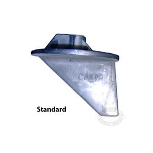

You can add a (name escapes me) trim tab thingy behind the prop. It's actualy an anode that will also help prevent corrosion to your outdrive. There's a mounting point under the AV plate behind the prop. It's sits with an offset to counter torque steer.

Philster it has one of those thing that you posted a picture of is that what you can adjust to make the steering alittle better and is that the anode also or should i be looking for something differant. And do you know how i would adjust the trim tab to make the steering a little better. ( And the steering is not so bad that it is affecting the overall operation of the boat just thought i would check into it )
Yes, it is also an anode to protect the drive. There is a bolt on the top that you loosen to turn it, the size escapes me now since its been a while since I've owned a merc. Adjust it like so:
http://www.marinemechanic.com/New-Folder2/trim-tab.gif
The attached image looks strange... just click the link instead.
