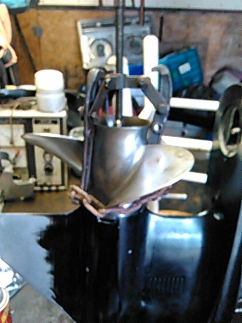

I got around to it today. The gear oil looks superb... no sign of metal flakes or water contamination. I pulled the lower unit and was able to shift the gears by turning the shift shaft. At first I was able to get it to shift into forward, neutral, and reverse. I installed then it would not shift out of forward. When I pulled it back out it would shift into neutral or forward but I could not get it to shift into reverse. From the outside it looks like a very nice clean lower unit. Big problem to begin with is that the prop is frozen onto the prop shaft so I'm up against a real booger from the start. I don't want to destroy this prop or the lower unit trying to get the prop off.... The only good thing is that it's a stainless steel prop so can take a good bit of abuse from me. Rather than trying to force the prop until it comes off the hub or prop shaft I have it rigged up with a chain and 3 prong puller. Tomorrow I plan to get out my good size hammer drill and bang on the end of the puller using jack hammer mode with some tension on the prop to try freeing it up without tearing it up.

You can try using a 2X4 between the prop blades and the gearcase "neck" and prying the prop off. Make sure to pry on all prop blades and use penetrating oil on the prop splines. If that doesn't get it, the puller is the next option.

I've got it chained with the 3 point puller .... even put the jack hammer to it and it won't budge after being soaked with PB over night... not good prognosis. Going to be far cheaper to just find an old motor or good lower unit... sad to sacrifice a beautiful prop and nice lower unit...

well, maybe the prop hub will let go and you can salvage the prop blades and get a new hub pressed in. After the prop blades pull off, you should be able to get to the stuck hub and grind a split in it and crack it off with a chistle.

Yep. That's kind of a last choice alternative. I already wonder where I can get a prop re-hubbed around here. That job has gotten expensive and all the prop shops I knew of have gone out of business.

You're probably gonna have to burn the rubber hub out to get that prop off. If it were aluminum and not a $$$ stainless prop, you could just cut the prop up, but I assume you'd like to save the stainless prop. You'll probably need a MAPP torch, at minimum, to get it hot enough.
And be very careful, the rubber will catch on fire, and spit out burning chunks & bits. The prop could even spit itself off the end, with force, flaming all the way. Don't ask me how I know this!
