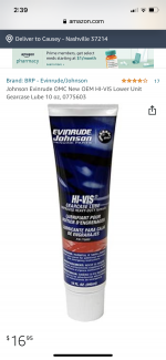

This may seem like a dumb question but…
The clymer shop manual isn’t specific for this motor. How do you figure out what gearcase your dealing with, mechanical, hydro mechanical, and mostly what I’m after is what lower unit gear lube I’m supposed to use. Is there a resource out there where I might find information specific to the 175 Evinrude? Need to buy some and some new plug gaskets.
Kaze
Seaman Apprentice
Nov 15, 2021
30
I think it’s supposed to be this
Honorary Supreme Mariner
39,949
If it shifts to FORWARD with a DOWN motion of the shift rod it is a hydro-mechanical shift.-----If the lower unit is original it has the Hydro-mechanical shift lower unit.-----Uses oil pressure to shift smoothly and easily.-----Yes HI-VIS oil is correct.
