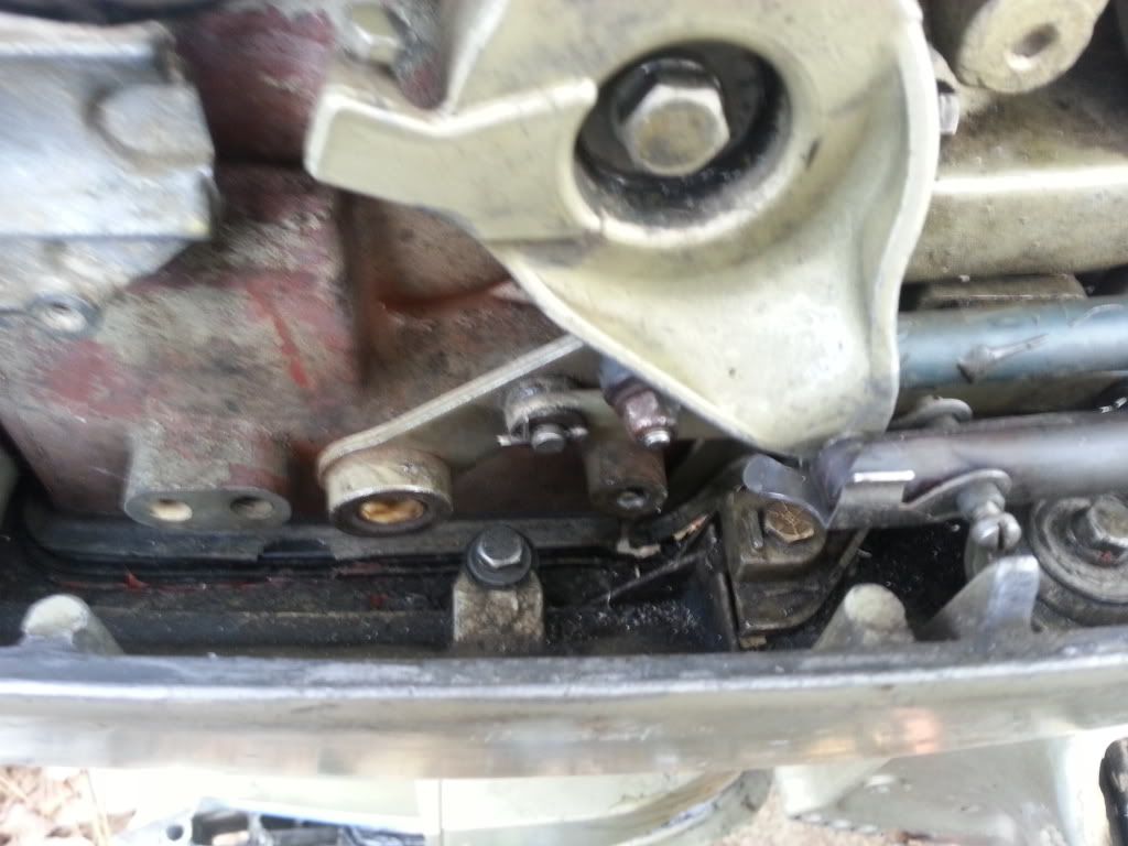

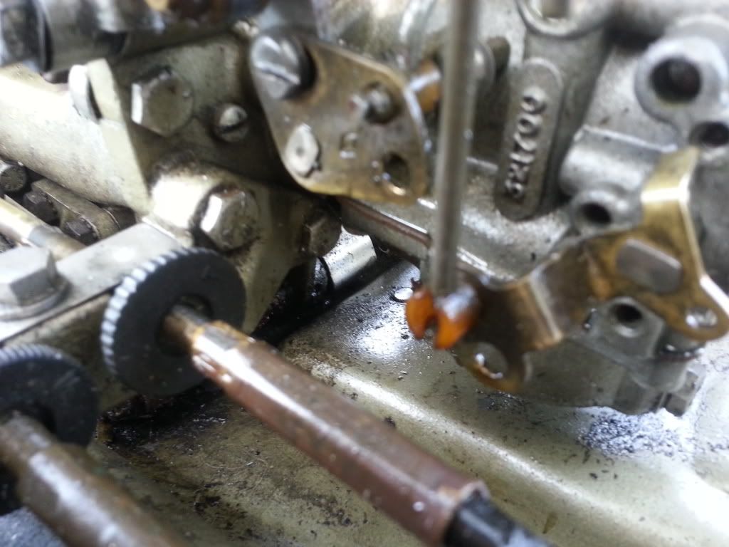

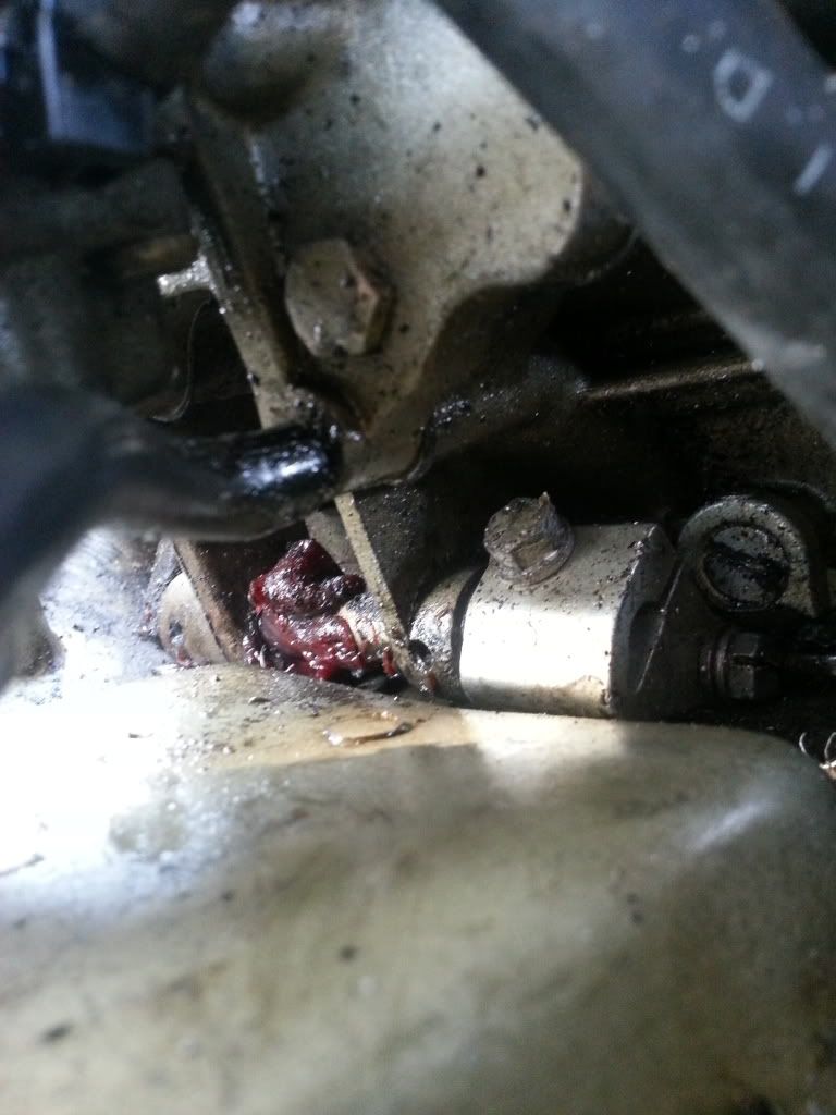

Alright I have the lower unit unbolted .. Looked at the diagram and still cant find the shift rod bolt. Here are some pictures if anyone can help.. figured id ask first because the two bolts and one screw are extremely hard to get to

In your last pic, see that slotted screw with the lockwasher under it ??. That's the screw you want to remove. It's on the shift linkage and runs horizonatly.

Oh ok! So after I unscrew that the lower end will be free? Is there away to mark the rod to make it easier to set the height? Ive never done this so thanks for the help I appreciate it!

That will disconnect the upper shift linkage and the l/u should come off.

According to your first pic it looks like the shift rod seal hsg bolts are either broken or removed ????

Are you resealing your LU because of water intrusion or servicing the water pump or both? Your pics dont show the driveshaft bearing and seal assembly.....pic 1 and 3 show the shift rod housing with the bolts removed which imo due to corrosion needs to be replaced.
