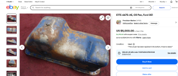

there are aftermarket replacement pans for PCM built ford installations. but they are pricey. I saw a factory ford Mercruiser pan on ebay a while back with $2000 or best offer.
