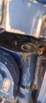

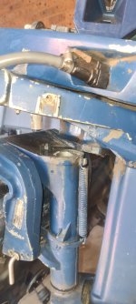

Iv had to strap the flywheel down tight to be able to get the nut off in the process the exuast has clean snaped I put a couple of pictures up not sure if it cracked when I hit the log or if it's just from straping the flywheel down to apply pressure or both
But dmg is done time to move onto the issue at hand
I have a 1978 spare parts motor im wondering if I can just swap the exhaust out and it will be all good or have I snaped some kind of housing that needs replacing as well or possibly if I can just swap the body with the exhaust from the 1978 spare parts to the 1976 running motor

I just need to know if the 78 exuast will work on the 76 or if I will need to order a new exuast
Also does anyone know of a good break down vidio for pulling a exuast out as it's not something iv done before

Also not 100% sure it's just the exuast that's snapped or the housing or something else
Ment to add these 2 photos not the video of me starting it to realise I snapped it

That being said, post a picture a little bit farther back, becauseI don't believe you've broken the exhaust at all. That is where the motor pivots to go right and left or port and starboard on your boat.
That shouldn't be that hard to get out other than sometimes if you're around a lot of salt they can be.
I'll do some checking to see if those two motors are compatible but I believe they probably are.

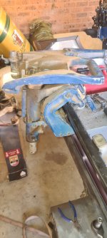

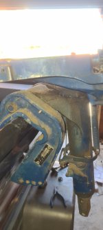

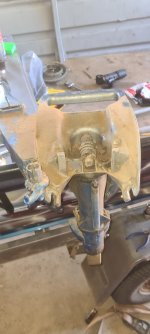

Hears a vido after I ripped the 78 apart to see what's going on should be a straight swap
And your right Definitely not the exuast like I thought it's the mount that snaped so as long as they align should be all good

Unfortunately can't do much else today as I have no degreaser or Greece gun to clean up the middle section from the old 78 that hasn't been started in 20 years according to the bloke I got it off

Is there anything else on this old middle section I should look at well it's off? Any seals on Greece points on the turning section? May as well do it right well it's off

Many ways to skin a cat but I'm pretty sure you could do it anyway you wanted to do.... your good.
As to the other question, grease, heat, time, money, bushings, seals, scraping, digging, cussing, bleeding, stroking, yep Happy Times!
