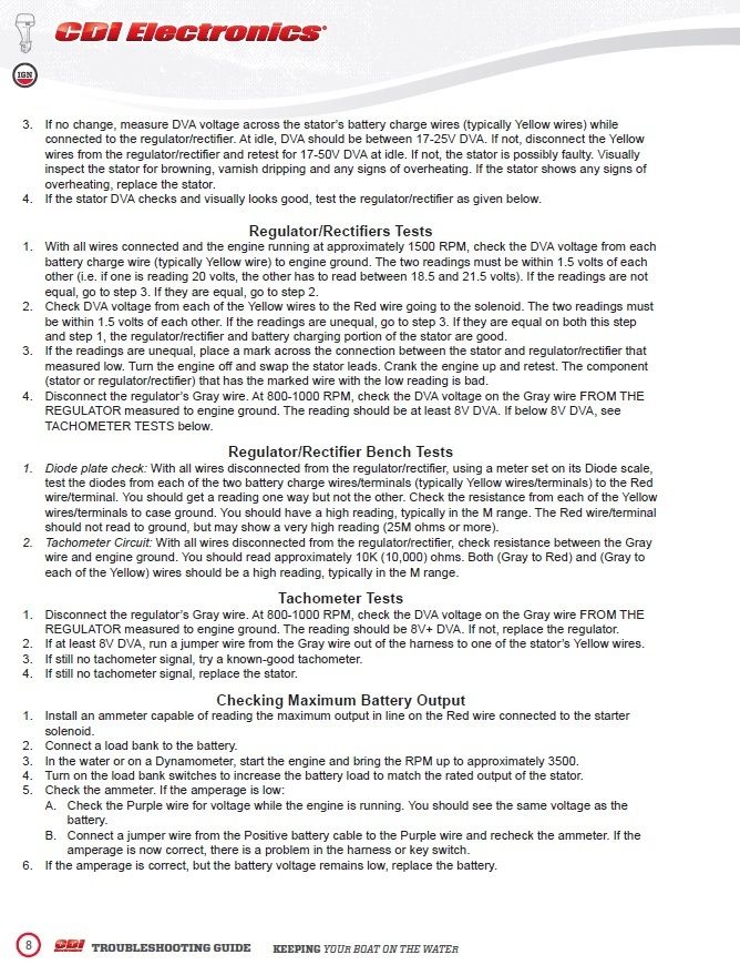

Do you know anyone that works on cars? A full system test with a midtronics battery tester works on outboards too, I use my exp-1000 all the time. It will tell you if your stator has no output or any bad diodes in your rectifier.
If that's not available here is how you test it according to CDI
