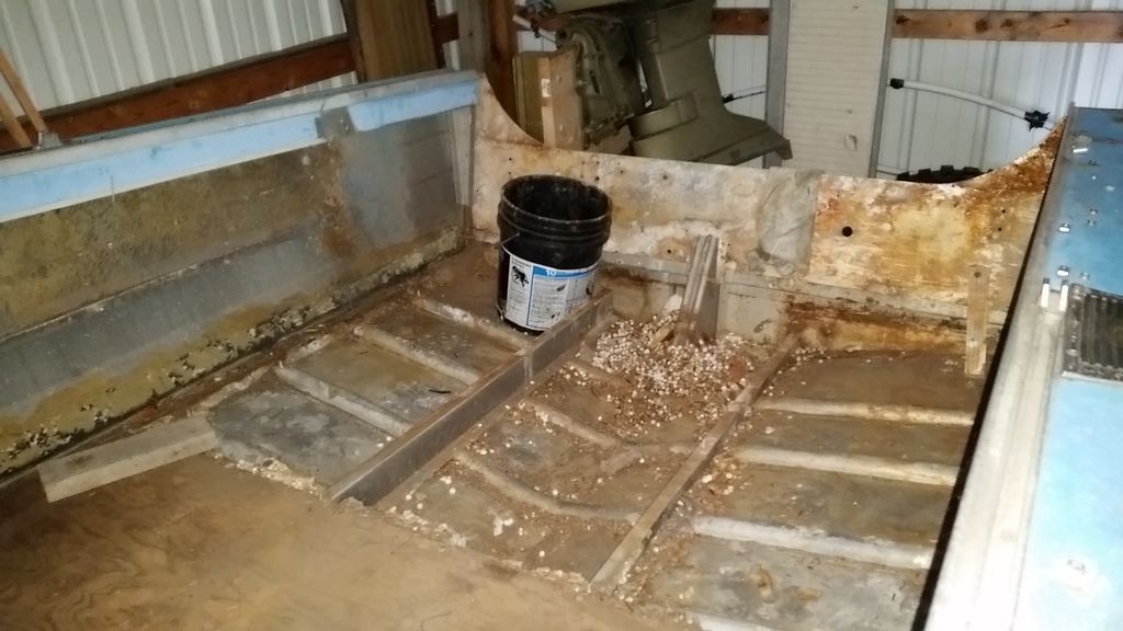

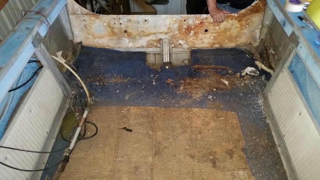

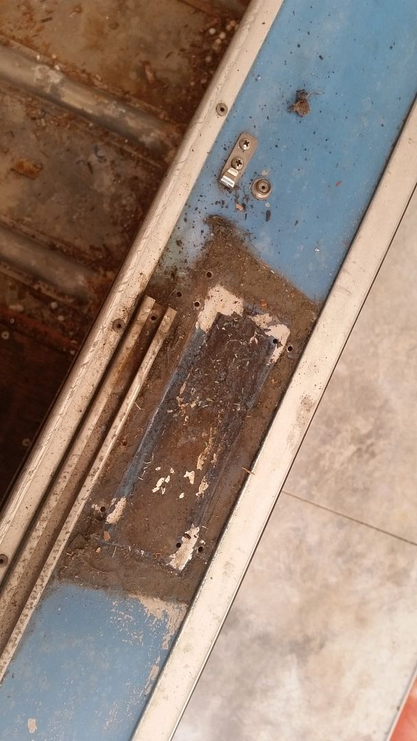

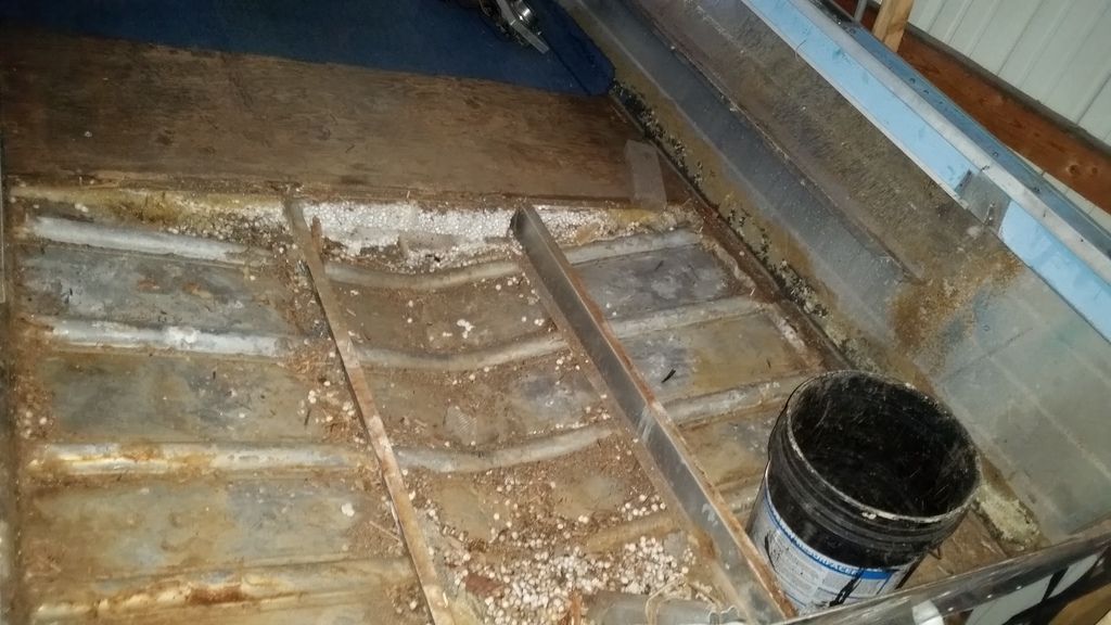

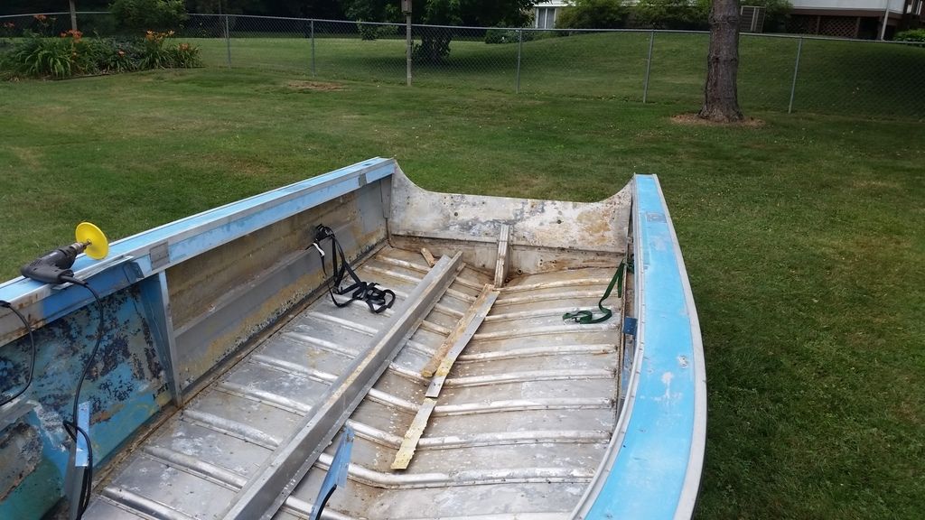

Flooring cut and test fit. 6 holes in the hull drilled, 5200'ed, and bucked with solid 3/16 brazier rivets. Hull vacuumed what feels like a dozen times preparing for gluvit today. Sanded the JB weld on the gunnels. Found several spots where there was still a small to medium divet where the JB sagged when it dried. Re-coated and will sand again today. May look to body filler if I still have issues. Not a show car... but I'd like to not know an army of holes once existed in my gunnel skin!

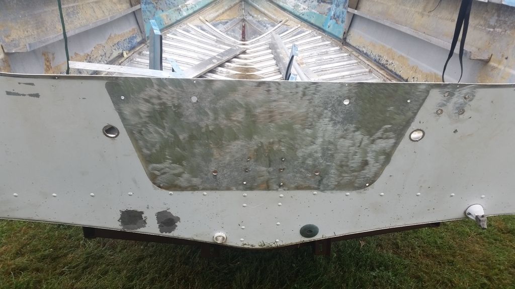

Transom cut, test fit, and glued. Will do the hard work today of getting it to slide in around the small aluminum flaps under those transom corner caps. Have not quite decided whether I'll cut and replace the transom in 3 pieces as the factory did or do some bending to make it work.
Stringers re-revieted down with the rivets Waterman recommended in his sticky. For those debating... the air rivet gun for pops is the way to go. Quick and pulled the stringers down really well. I did get some clecos to to help with assembly and they were great to hold the stringers in place (one had all of the rivets break or come loose) while I worked on aligning and re-riveting. They were even strong enough to place the floor boards and do some test fitting with me crawling around on top of it. A must have for riveted craft if you can swing getting a set.
Went with Epifanes for my varnish. Did the first coat tinning with plain old mineral spirits last night per their directions. Might not have tinned to 50%, but it thinned out quite a bit and didn't end up using the entire first coat (one side only). Figure I'll finish that can up today so this stuff might go farther than anticipated (bought 6 "quart" cans in preparation). A few pictures follow. Hope to have more after I wrap up what I can before midnight today.
