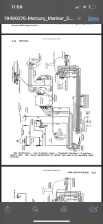

Just picked up a 1973 glastron v-156 sportster and it has a 1974 mercury 850 outboard motor. Was wondering if anyone had a wiring diagram for the boat or help with getting my engine started?

@QBhoy, thank you so much for the info I bought the manual I found for it and that has also been a big help. My next problem is figuring out putting a new ignition key in and where the wires go. If you can send me a picture of an ignition key that would work that would be a big help. I attached a photo of the wires which are the ones that go with the diagram I also attached below, colors are brown, black, red, white, yellow, and salmon, and gray. I also have a different remote control that doesn't hook up like it shows in the diagram so I am trying to figure out an ignition key that would hook up to them and what all the wires hook up to. Thanks so much!

Hi. Good stuff. If you don’t mind me being blunt..if I were you…I’d definitely just buy a good used remote control box and loom, as close to the engines era as possible. Will have an ignition barrel and key integrated into the box.

Nothing wrong with that I just can't seem to find one, maybe I am not looking very hard enough I just wish I could use the one I have:(
