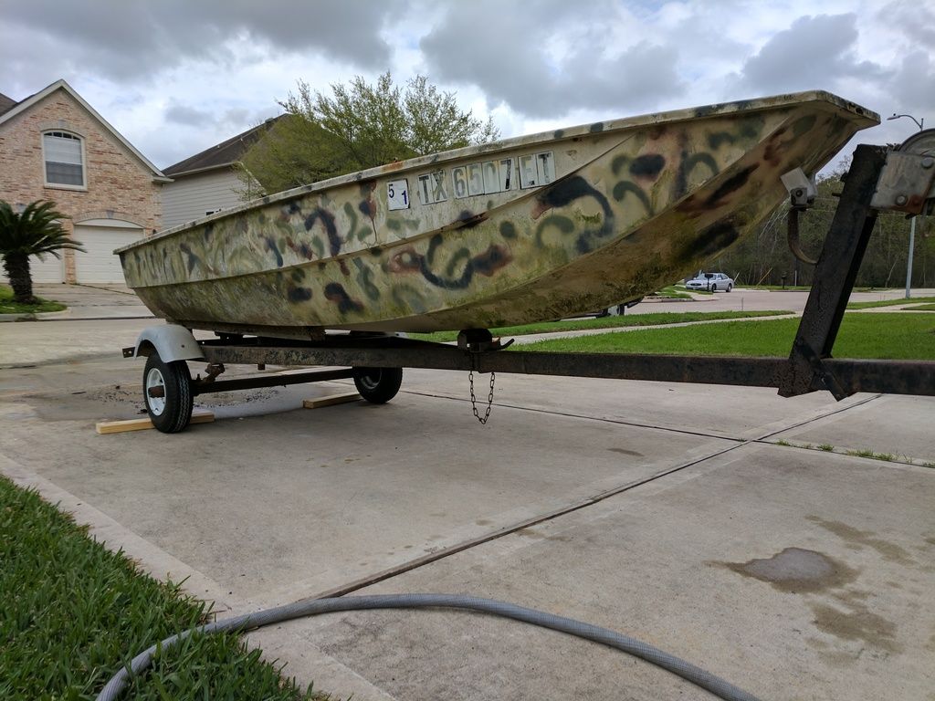

For years my stepdad has offered to give me the boat settings in his back yard. After moving back to TX I finally decided to take him up on the offer. As you can see from the ad I'm estimating it's a 72.
It was previously owned by an old hunting buddy of ours and as you can see it was painted to be a duck boat. The long tail mud motor was added later and was never run on the boat. It was last licensed in '01.
After lots of cleaning to remove an ant colony and remains is an old mouse nest I could survey the project. The boat seems sound minus the transom and the very front of the bow. After lots of research and YouTube videos I got the nerve to open up the transom. I guess the good news is it was so rotted the wood scrapes out with little resistance.
I was conservative with my first cut. Didn't want to cut away too much since I didn't know the actual shape of transom.
