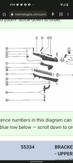

So it looks like the interconnect cable hooks to part 14. But this one in the picture doesn't show it the same as mine with the arm sticking out the other way that the interconnect cable attached to. However in the starter cord housing parts diagram the interconnect cable is in the parts diagram. So my question is do I replace part or forgo the use of the interconnect cable? Will I compromise some kind of safety?
