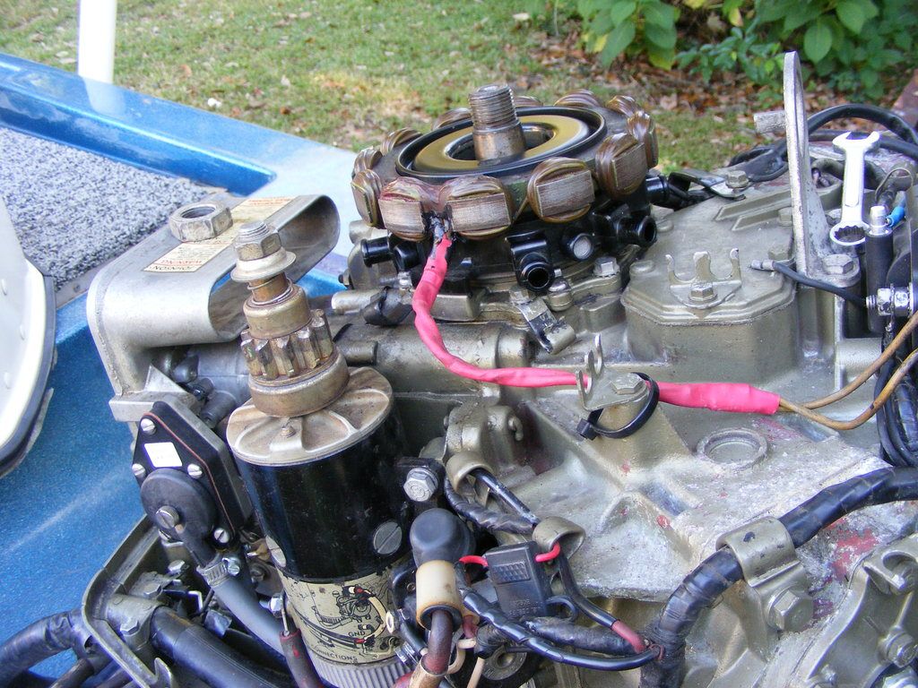

this is my '72 Johnson 100 - notice the extreme wear on the original starter bendix!!! lol Brand new distributor cap and fuel pump; found insulation broken off at stator and repaired with liquid electric tape. Stator has not yet been re-installed, was thinking I'd use the one off of the 115 I just bought. NOT gonna happen! It will work, but that 115 is in too good a shape to be a parts motor...
