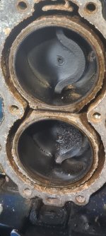

Main reason for the rebuild is a damaged piston the previous owner had the wrong spark plugs in and the end of the piston was bashing against the spark plug
But mostly just a winter project clean the old girl right up new paint job the whole kit and kabodle so I'll have a good motor for years to come at a low price

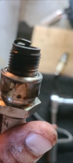

They were the wrong spark plugs in there they were to long I swaped em out for the correct spark plugs awhile ago

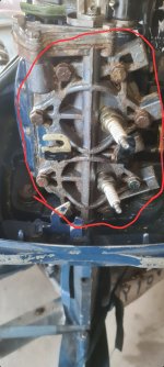

Hit a log and the sudden jolt musta had just the right timing but the piston slamed the spark plug right outta the hole striped the thread lucky iv got the spare parts motor just straight swaped the piston head cover so I didn't have to retread the bastard

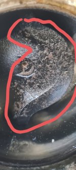

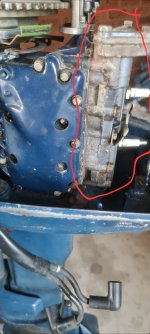

Can you circle the damage on the piston that was caused by the long plug ?
nick271
Mar 20, 2024
59

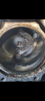

Not sure if this was caused by the wrong spark plug being to long or what caused it but it definitely doesn't look right
The main dmg was caused when I hit a log on the river and the piston hit the spark plug hard enough to pop the spark plug out taking the thread from the head off
But I have fixed the thread problem the same day it happened by just straight swaping the piston cover off the spare parts motor
Can see the part I mean by 2 different paint jobs
Much easier than re threading
But im not sure if the damage to the end of the piston is causing problems or impending profomance

I have a couple of brand new 0.030" O/S pistons that have the same horseshoe shaped indent in them.
nick271
Mar 20, 2024
59
Do ya recon it's damage or just build up? Or do you mean brand new unused with the same bumps?
I have a 78 25hp rude not sure if pistons are compatible 76 being 22in cube 78 being 33in cube but the pistons on the 78 look clean with no indents
Honorary Supreme Mariner
39,942
I do not see any clear damage to the piston.----And the 33 cube parts are totally different.----I have worked on more than 1 or 2 of these engines !
