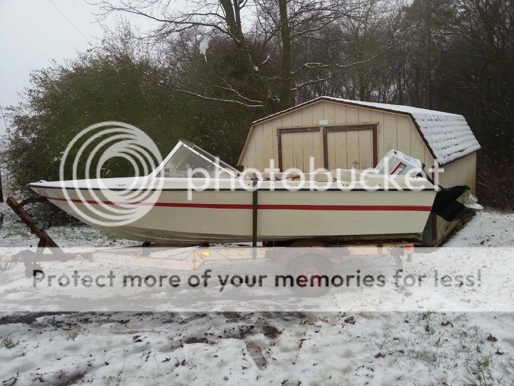

Hello I just picked up a 70 v-150 deluxe for free with a trailer both need work the guy I got I from started tearing out looks like black and white speckled vinyl. This is my first boat and I don't know much about them I know I measured it from the back to the point and it is like 18ft the guy told me that the motor only needed some pin to run he got it for free also and didn't know much about it either both seats are there but the right side look like it got ripped off the floor and the seats are off the frame and the right side panel is took off and there is the posts on the side that are rotted I don't know if floor is rotted it looks solid but its snowing a lot right now and I cant get outside to get in it to really check I just didn't know if the side posts where the panels go are attached to floor some how and how to really check to see if floor is rotted any help is appreciated and im guessing on the year I know the evinrude is a 70 and the boat doesn't have a HIN it has a 6 or 7 digit serial number with a flap in the windshield which is cracked but I work at a glass company so I can get that straight but other then that im a newbie

Well here some of the pics I gave right now and I don't have no paperwork I live in Delaware though and the research I did said I should be fine im gonna check it out more before I put money into her
