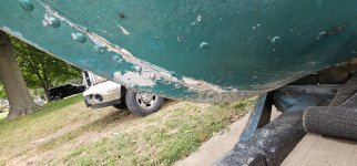

Still nothing new to report. I keep forgetting to buy a drain plug for it. It is holding some water well. It has rained a lot lately and we are supposed to get up to another 7 inches of rain tonight. I could leak test it if I had a plug in it. 🤣

Your drain plug method is certainly a test that's been used successfully many times in the past! But please don;t do that until you have the trailer tailored to fit the hull! All that water weight could do tremendous damage to the hull. But it does seem to have passed both it's strength AND leak test during it's previous life in the boonies! Have you thought of a TINY (not much bigger than a leaning post) center console? This will be a great family boat!

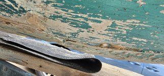

As seen in the picture above, the side bunks need covered and adjusted. There is some wear on the boat where those rollers touch. I assume it if from years of sitting on the trailer not strapped down and allowed to move around in the wind and such. The roller trays underneath are quite a ways off also. I need to get the boat off the trailer and get that adjusted as well as rewired.

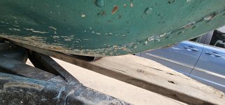

Anyone have any thoughts on the trailer? I don't know anything about how a boat should sit on a trailer so I don't know if this is right or not.

To be honest, the trailer looks like its in pretty rough shape based on the pictures. I'd start by stripping those rusted side guides and raw wood off, as well as that makeshift wood cross member for the transom support. Your rear rollers should really be aligned with the transom as that is where the bulk of the weight rides. Your boat is currently sitting too far back on the trailer and you risk hooking your hull if left that way. When the hull is stripped, it's not a big chore to get it off the trailer and allow you a better opportunity to look over the trailer. I couldn't tell if the rear frame on the port side was bent, or just the angle of the photo. I'd assess whether its worth the effort of a rebuild, or if your better off finding a replacement. You'll definitely want to check the tires(likely need replacing) and repack the bearings/replace seals, which should be done as regular maintenance. Once the hull is off, some additional pictures would be helpful as I can't really see much of the bunk/roller set up. Any old wood I'd also tear off to ensure there is no pressure treated anywhere on the trailer. The trailer is actually more important than the boat from a safety perspective. There's a lot at risk if it's not up to the task and can wipe away all the effort of your restoration in a heartbeat.

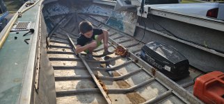

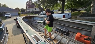

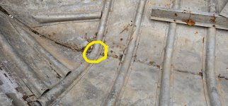

Well, here we go again. We've had some decent weather lately and my 8 year old has been asking about getting the boat ready, so I drug it out of the backyard, up to the driveway. He helped me clean the dirt and leaves out and used an antenna to clean the drain channel under the ribs. Then he rinsed the boat out and I started planning the seating layout. I'm still stuck on what to use for a console or what to build one out of.

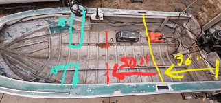

A metal bender or press and some AL sheet could make consoles pretty quick. Maybe not as sharp as stock but close enough. Once the foam/floor is in you could get exact measurements for the height you want.
I ran a magnet along all my ribs too, was amazed at what came out from under them.

I'll probably end up fabbing a console that way. I may just make the one in it work for the sake of getting it on the water. I've never thought about using a magnet, but it seems like no matter how much compressed air and water I send through the ribs, stuff keeps coming out. I have an ADHD/OCD paranoia that once I put the floor in, they'll clog again and water will get stuck sitting under the floor.

That was my other thought as well - fab the consoles later and get on the water the way it is now. Hopefully where you mount the seats work so thats just another variable.

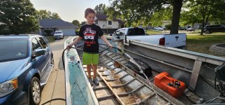

I got a wild hair the other day and thought I'd hook power and ground to my truck battery to see if it would turn over. Then thought why not see if it'll try to fire? So, I hooked up power and ground, got my muffs and the garden hose out, and grabbed my 3 gallon john boat tank and hose and gave it a whirl. It's the little wins, right?

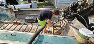

Weeelllllll.... Today was good and bad. I've been wanting to put the boat on the water and see if it leaks for 2 summers now. I had some time today before work to do that, so I did. My 8 year old son wanted to come along and I needed someone in the boat to look for leaks, so it worked out. Now for the downside.... I wasn't as prepared for this trip as I thought I was. We left the house and I had forgotten to slime the boat trailer tires (both tired have slow leaks). So we stopped in the next town at a local parts store to grab some Slime. That's when I realized that I didn't have a safety chain on the trailer either. 🤦‍♂️ The parts store only stocked a rather expensive safety cable, so I passed. We went across the street to a hardware store to buy some bulk chain and came across a Reese pre-made safety chain on the shelf so I bought that. I grabbed 2 small cans of Fix-A-Flat and paid and went back outside. We flattened both boat trailer tires and started with the Fix-A-Flat. It didn't take me long to remember why I hate using that stuff. Neither can had enough pressure to air up either tire. I do think I managed to get about half a can in each tire of the Fix-A-Flat stuff itself. I used my battery powered air pump to get each tire up to 30psi and then went over to the gas station to top them off. 70psi and we were on our way. We get to the lake and it is freakin WINDY. like 30+ mph steady winds. I picked up a Minn Kota Endura Max 45lb transom mount trolling motor for my Jon boat and thought I'd give it a whirl on the Starcraft. WAY too windy so we didn't try it out. I put my 8 year old in the boat, unstrapped the back, and backed it into the lake. Then I climbed across the bed of the truck, down the trailer tongue, to the winch. I let out about 6ft of the strap and pushed the boat out to float. Then it got even better. I had backed in on the downwind side of the dock hoping it would block some of the wind. Not exactly. The boat got crooked before I could winch it back up and I couldn't get it around the guide pole to straighten it up. When I tried to pull it out of the water, it rested on the rear guide pole and tried to rollover. I dont think my 8 year old will help with that again. 🤣 I was able to go over to the dock and throw a rope with a carabiner to my son who wrapped it around the rear tie point and I was able to pull it over onto the trailer. Now, for the leaks. Because there are some. The leakiest part was 2 holes above the drain plug where something had been mounted at some point and the right rear corner of the boat. There was the slightest dribble from the front where the boat starts it's curve upward. The underside of the boat at the curve looks a little rough. I think some Gluv It will solve that. The 2 holes in the transom just have some old silicone in them. I'll clean that out and fill those in. Hopefully, when I get back from vacation next week, I can try again in some calmer water. My boy earned him some pizza for riding out the mishap in the boat during testing. Lol.
