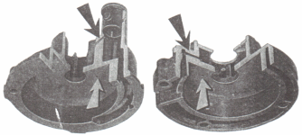

btw some pumps have VERY small holes that must be cleared for proper operation ( I think it prevents air locks or something
see picture... check housing for your's
