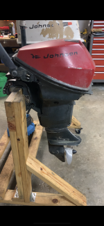

I recently bought a 1966 Johnson 9.5 hp for around a $100. The previous owner claimed it ran 3 years ago but snapped the pull cord and it has been sitting since. Condition is better than most that I've seen online (paint and stickers still clean and has been stored). Is this a motor that is going to be difficult to find parts for? what is everyones thoughts on this model and year of this motor (is it garbage or worth fixing)? Let me know!

compression is usually low 70s great motor ideal for trolling- casting
parts available everywhere
change the impeller - gear oil- replace pull cord lots of info available on it
early ones shook a lot ... later ones came with vibration dampners on each side of the power head .
ignition info. you likely will need new coils if never replaced . ... lots of utubes for you.. nothing you can't do yourself... great hobby . if you do coils change wires and plug boots with solid metallic strand wire (no carbon fiber wires)
can you turn the fw by hand ?? ... could be just rings stuck ...oil cyldenders face down for a few days
carb must be sweaky clean lots of utubes

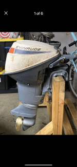

the 1966 Evinrude version next to my 75 ETEC is actually a 9622a mdl with the vibration kit :)
Ran all day long trolling without complaints (65 psi) and provided peace of mind if ever the fancy ETEC would leave me 10 miles out on a windy Northern lake.
Up here in the great white North during melting season that little kicker was.. possibly still is a favorite of fly-in trips thanks to it's compactness ( & hidden carry handle).
