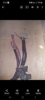

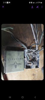

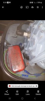

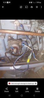

Hey i also have a 1966 evinrude Lark 8 40hp electric start i payed $25 for it it has no controls i was wondering if i need to find a junction box and controls to run this ir can i use a manual.shifter cable and.not.hook up the elecric.shift

You can not hook up any kind of manual cable to shift this motor.----Needs 12 volts to green for forward.----And 12 volts to blue for reverse.-----Needs a working belt driven generator as well.----Your location ?------Best to do a complete evaluation before spending any beer tokens on it.----Post compression numbers.---Test shift coils.----Pull flywheel and inspect ignition coils.----Install a new water pump impeller before launching the boat with this motor.
39,864
Finding a push button shift control box may be a challenge.-----Finding a junction box with a good voltage regulator may be a challenge.----First determine if motor is going to be a runner !!

Ok is it safe to atleast hook up positive,ground, and white is ignition for electric start right? Just to test before i dump money in it ? And if all runs can you send me a picture of whate control box and controls look like so i can search what i need ive looked online cant find

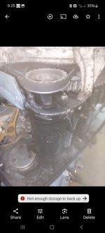

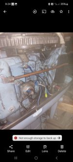

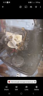

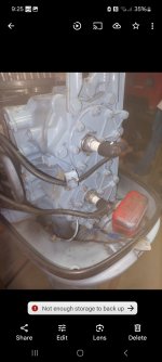

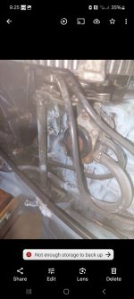

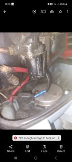

The junction box also needs the voltage regulator.----Post some pictures of the powerhead.----I am too far away to provide any more help.

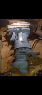

Sorry-----I do not consider that to be a " clean " motor.-----Good luck with it.----Model # is ?----Serial numbers the same on swivel bracket and powerhead?

Yes the model.number is the same.on the swivel.bracket how do i test the shift coils and location.of.them?
