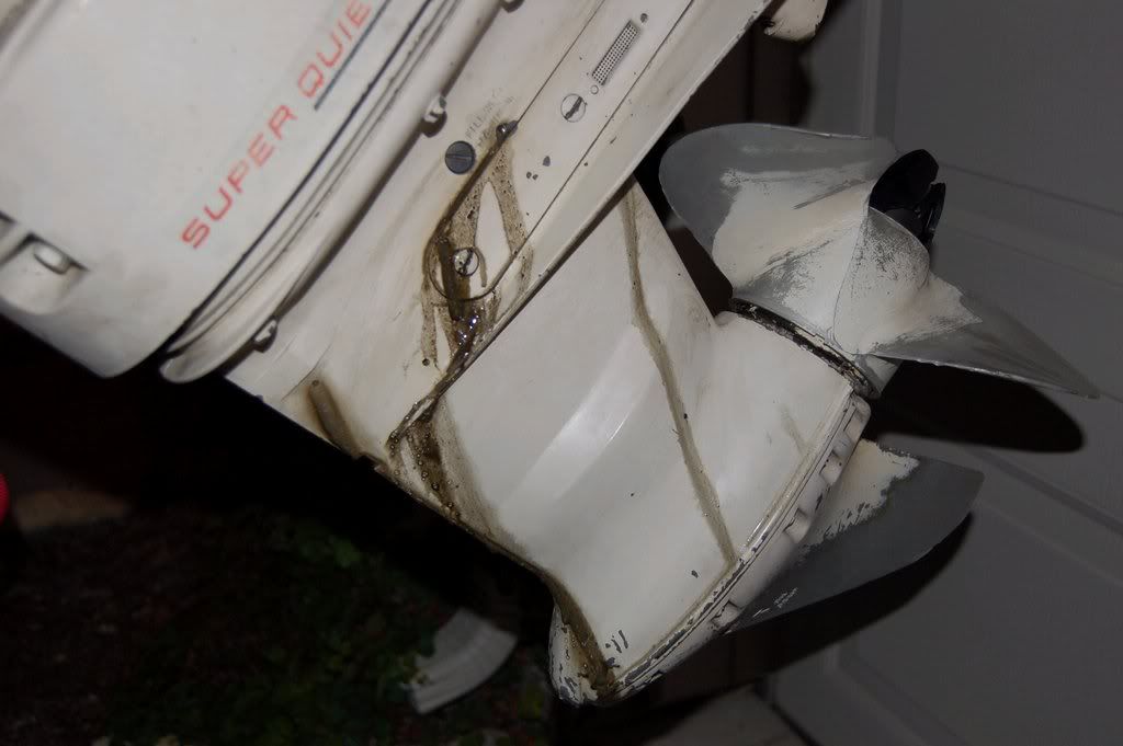

Also, I tried to upload a pic of an oil leak out of the lower unit, but the pic was supersized and to big for iboats to load.
The leak is a light yellowish fluid that is comming out of a little hole in front of the long skinny plate just next to what i think is the water intake.
I took the boat out for a quick spin to see if it would go today. It took a little choking to get it going. With wot it seemed low on power and it keept kicking me(seemed like it would occasionaly miss, causing a kick). After I got home, the oil comming out of the lower unit seemed greyish and instead of comming out of the pinnhole, seemed to be comming out of the long skinney plate.

57whitehouse
Jun 18, 2007
519
Re: 1959? johnson superhorse 50
Here is a pic of the leak. Does it look like a shift rod seal?
F_R
Honorary Supreme Mariner
Jul 7, 2006
28,226
Well, you said the gearcase oil was cream colored, not black. Looks moe like fuel/oil that has gone through the engine and out the exhaust, picking up black carbon particles, then coming out the drain holes. Remember, that 50 dumps huge amounts of fuel out the exhaust. Can't help that part.
But that is not to say it cannot also have a shift rod seal leaking. I'm not 100% sure, but it probably can be replaced like the 75hp. Merely remove the shift rod and hook the seal out like you would a fuel connector o-ring.
