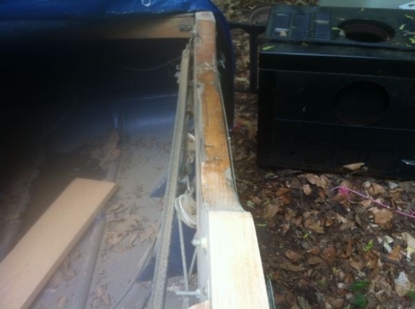

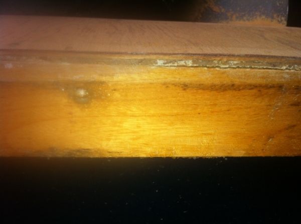

So, here's what's been done so far.
First off, I started pulling the screws for the cap - the P.O. used galvanized machine screws to hold the trim pieces to the hull... what a rusty mess. On top of that, the oak trim wasn't fully dry so now it's shrunk, holding those screws tighter than anything. Having a heck of a time pulling em. I'm glad there is only.... you know... 125 of em (at rough count).:facepalm:
The transom was replaced by the P.O. and he used a beautiful piece of oak. Unfortunately, being that it was a solid piece, it's starting to crack as it's drying. That'll be replaced by some laminated ply, soaked in epoxy.
The ply for the cap and gunwales is very light, 1/4# ply... it doesn't look like an exterior grade or anything. That'll also be replaced by some heavier ply.
Dash looks decent, I may just clean it up and use what is there - havent fully decided on that yet.
Seating isn't terrible - the P.O. made up some seat cushions for himself, and I'll probably end up using those until I find a cheap alternative - I love the look of the front seats on the original, but that may be out of my limited woodworking skills. When we get to that point, we'll have to see what happens!:D
I've got everything but the trim pulled off of the hull right now - i'll get some photos of that in a bit. 2 days ago, I got some epoxy from U.S. Composites, so soon we'll be into the rebuild phase!

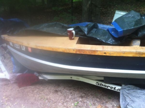

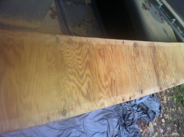

Some random pictures to keep the mob happy.
Transom after partial sanding, before I decided to remove it.
Port side gunwale after sanding
Cap after sanding, with required coffee mug! :D
