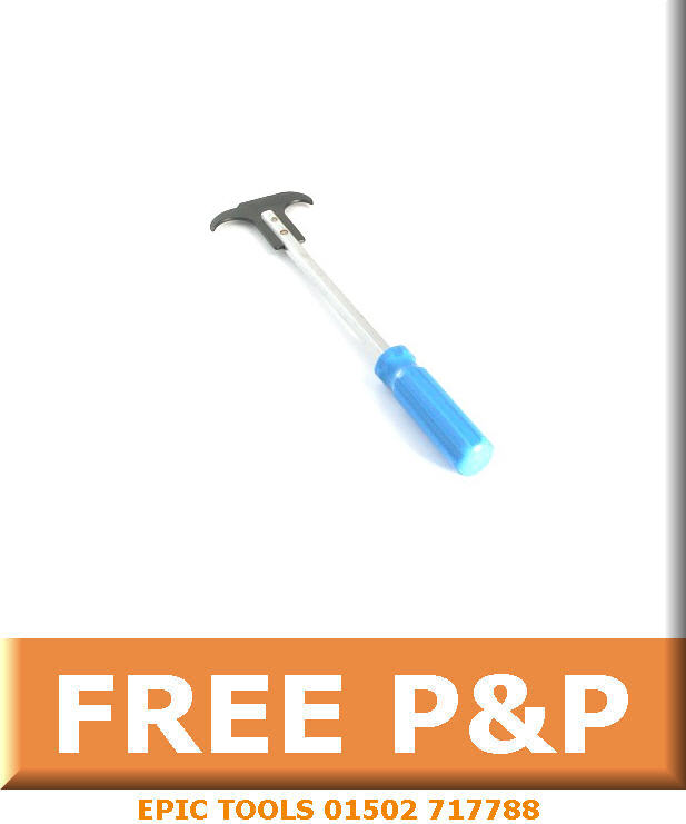

OK, I am working on sealing up the gear housing as it was leaking very badly. I have all of the new parts but could use some advise on installing them. How do i get the old shaft seal out and in properly? Any tips on putting the rope seal in properly? What is the proper way to fill with oil once complete?

Hi Macaronio. Great lookin' little motor. Here's a great link that can walk you through changing the seals. It's for a different model, but the steps are the same. You don't need any special tools aside from a seal puller, which you can get at any auto parts store for about $10. They usually look something like this: http://imagehost.vendio.com/a/28304091/aview/sl_seal_puller.jpg
How to change oil seals link:
http://forums.iboats.com/showthread.php?t=277190&highlight=lower+unit+seal+kit+installation
