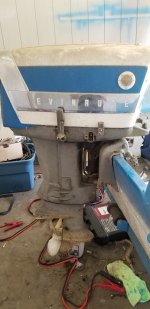

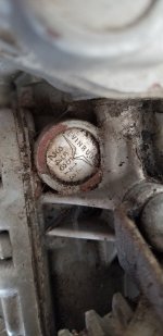

I believe there are 2 different models of 35 HP with different water pumps.----Are there 2 water tubes on the pump or just 1 ?------Post pictures of this motor.---And is the model # correct ?
I have no clue as I haven't pulled it apart yet. Here is a pic of the motor serial number and motor.

That pump will have 2 tubes I think.-----impeller is 777213, ---plate 312613,----housing is 378348 ------Some will argue.-----My approach would be to inspect the parts FIRST as you may only need an impeller.------Complete kit is available ( often not listed for 58 models ) and may not fit in your budget !!!----There is a kit available that will work, yes there is !.------I would first evaluate this motor before spending beer tokens on parts !----How did the motor run for you last season ??-----Note---I do own a 58 Johnson model which is the same motor.

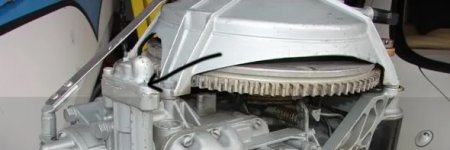

Yep found it :). Still doesnt want to slide out but does move freely now. I've watched a few videos on newer motors and they have a linkage they have to disconnect. Is there something like that that I'm missing or do I just need to give it a good yank?

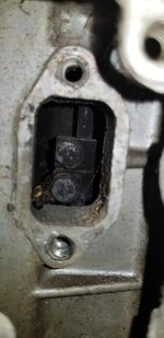

Guessing this is the linkage I was missing. Sorry I'm new to working on motors so this is all a learning experience for me.

Put hammers away and stop yanking.-----Remove 2 wee covers on the side and REMOVE one bolts from shift rod connecter.-----Do a complete evaluation of this motor BEFORE spending any beer tokens.-----Be silly to have a $200 water pump kit for a motor that is JUNK in my opinion.

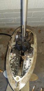

Yea I have been working on the rest of the motor. Had a friend check it out and he said it had good compression and spark. I've already rebuilt the carb and fuel pump as well as a new starter motor. Got the lower unit off and the housing looks good so wont nee to get that. Thanks for the help.

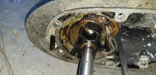

You may just need a new impeller.
Ty. That is what it is looking like. There was a type of ring on top of the housing that still looked fine. The housing as well looked fine. The impeller had all but 2 fine broken off so that definitely needs replacing. The metal plate below the impeller needs to be cleaned up but also looks fine.
