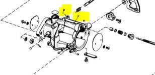

what is... I rebuilt the carburetor thoroughly .....
did you pull the top dime size plug and clean the low speed circuit incl. the VERY narrow side channel that sucks fuel from the lower carb bowl half. the upper half has a very small passage leading fuel to the top chamber wher the point LS needle allows fuel to enter the chamber with 3 small drip holes.
did you install enought packing on the LS sneedle

seems the top dime size plug is generally aluminum whereas the actual lead plugs are BB sized inserts and used to seal certain passages normally not fooled with.. by me anyway.
