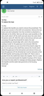

This was a thread I received from the man I bought this from 3 years ago! He had gone through it but couldn’t remember! We were wondering if there was any other way to do it!
