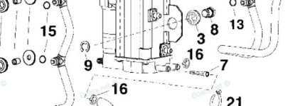

have you done the basics... checked fuel delivery ..filters . that engine seems to have a vapor separtor much like the newer ETEC VST 2005 + .
not shown on some parts diagram is a small conical filter in the fuel route at the bottom of the VST which can and could be plugged with "old" hose residues. VST nipples are brittle DO NOT FORCE $$$$ . you can pull it out with just a large wood screw .. turn & pull it out )

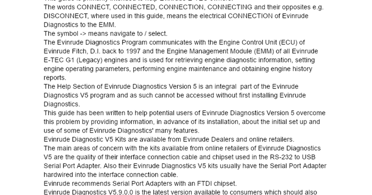

you could try to get the maintenance software and look in for fault codes which would point you in the proper direction to happiness. Do searches on the ETEC board to find postings on free EV diagnostic SW download links .
the computer checks a lot of symptoms and without "looking in" with the support software you are basically blind.
FICHT engines seem to have bad reputation yet some love them. If the engine slepped for 5 years .. or more... anything goes I guess .
The etec owner' board does not support FICHT owners... but you could do searches on previous posts to located the EV diagnostic SW you can download free . there is lots of info on how to use the SW

see descrp.. if you ever need it my understanding is that the boot strap cable goes beyond the regular triangle access cable.. on my 2005 ETEC anyway. maybe FICHTs are different ... the triangular cable access is less.... dangerous EMM brain access and transplants wise
Bootstrap tool for Evinrude Outboard Engines​
Bootstrap tool (brp p/n 586551) is an evinrude tool for updating and restoring emm in evinrude outboards.
With this tool you could do:​
  • emm software update (user could upload newest engine map software updates to the e-tec emm),
  • emm recovery (user could bring the emm system back to a communicating level),
  • replace oil pump,
  • replace injector and write injector data file to emm.
With this tool, you will get a cd with newest map packages for evinrude e-tec outboards, diagnostic sw with latest updates and quick manual how to use this tool.
boot cable is for serious brain surgery .
you can do searches on the ETEC owners site GEB is the man imho SW wise lots of ETEC experts there but they don't usually help out on FICHT engines but....a lot of their posted comments and links can help out.
at best with the basic SW version (I have v 5.1) you can at least see if you trouble codes causing shut downs. I do not have both lists but FICHT and ETEC fault codes are somewhat similar.
