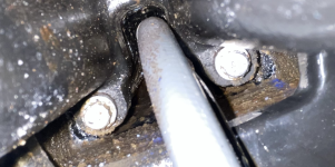

UPDATE: Dropped her in the harbor and found the leak in lower transom assembly area where trim hoses penetrate. I could not see where the actual leak is, but this area fills with water, about 3ozl per minutes, then drips down the inside of the transom. I tried to suck the water out while submerged to get a video with my inspection camera, but it filled back up almost immediately.
Here's a photo after I drained and dried it out. It's behind, and under the YPipe, and very hard to reach.
Is the hose penetration serviceable after removing the bell housing on the outside? or, do I need to pull the motor to get to this repair?
