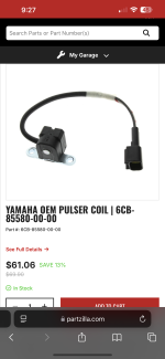

Hey, No I don't have the factory manual for the diagnosing procedure, do you know how can i get it. A couple minutes ago I was reading and I saw that there are 2 meaning of pulser coil there is the one that goes under the flying wheel and this one. I dont know if that also has something to do with it.

Briefly looking I found from Yamaha:
I also found what appears an official Yamaha owners & service manual finding website where you can find the part number and buy from them if need be:
You may need to consult with your closest Yamaha outboard dealer to verify the correct service manual part number. Those manuals are not cheap but necessary.
