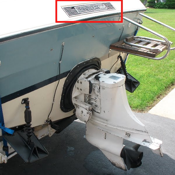

While a slightly ripped transom seal may be ok, it could also be a sign of very bad things. That seal fills in the gap between the drive & the transom, so when it leaks, it leaks a lot! His boat may have been underwater or severely water-logged by that "slight rip".
Regardless, it's an obsolete & antiquated drive made by a company that has been out of business for over 12 years. I have one. Walk away & go look for a Mercruiser or Volvo unless you are very mechanically inclined, have money to play with & aren't afraid of being in the position of not finding critical parts when things break.
The black rubber "boot" around my drive is what he's talking about having a rip in it (ignore the red box around the name plate):
