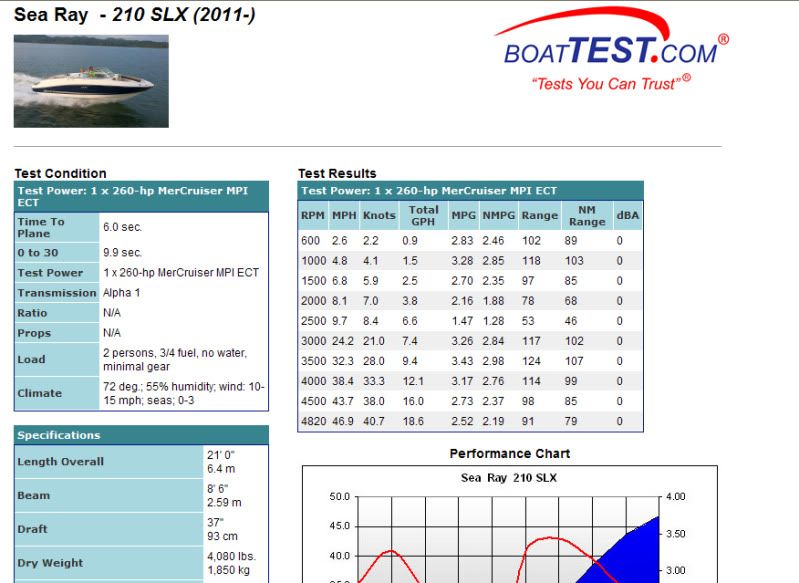

Had it out yesterday and started with 391.6 hrs and ended with 394.3 pulling skiers all day at 25 to 35 miles an hour it used 14 gal of fuel.
If you have a 1993 5.7L that only uses 5.2 GPH pulling skiers between 25 and 35 MPH I wouldn't touch it. A brand new, lightly loaded, fuel injected 260HP 5.0 uses 7 to 10 GPH at the same speeds just cruising, not pulling anything.
