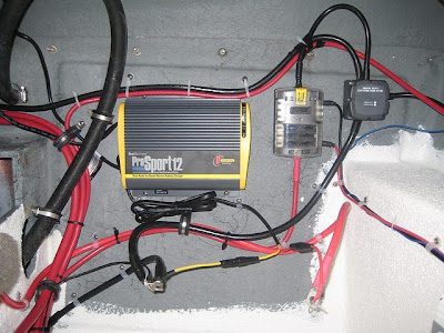

This is where I hid the mine (port-side stern)... Plan on same with my new boat.
