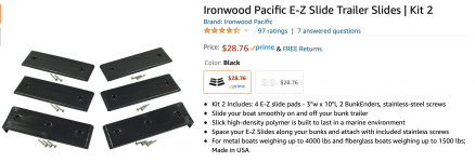

Years ago when I purchased my 2007 rig new I was going to screw on the 4 plastic slips on the bunk carpet. But I remember Amazon had a disclaimer not to use them on painted hulls. Is this still the case? I had to move my rig a few inches forward to adjust the tongue weight and make room to attach an auto tiedown for the bow hook. Since my hull has rivets all along the transom and the transom is now a couple of inches before the end of the bunk I'm sure it will eventually wear or tear carpet which happened on my first set of bunks that rotted out after a few years and I replaced them 6 years ago with Cypress Clear a harder wood then the crap that came on the trailer.
It's aluminum. I can't see it anyway even if some paint scraped off from the slips.
Opinion to use them or not.
Thx

My opinion is don't, but not because of Amazon.
I once bought a brand new Starcraft tinny. It came with a bunk trailer. The boat was my fishing rig and it had to be a solo launch. I could not push that sucker off the crappy carpeted bunks by myself.
Since I had stellar performance on my FG boat with the Ironwood product, I bought a set and installed them on the bunks. I relocate the bunks so they would sit on flat aluminum with no rivets. Maybe not worse, but certainly no better. I ended up throwing the carpets and wood in the trash and installed full roller bunks.
I can't imagine what the difference is between gelcote and paint, but there must be something. My jetski and Boston Whaler have EZSlides on the carpeted wood and they both slide off like gangbusters...

Correct my boat is not painted. I really honk polyurethane is the way to go. I would check with the company that makes them to see if they are not compatible with painted boats.

Wondering outloud, I'm wondering if this plastic is so soft that you could imbed sand or other abrasives into it's surface?That would do a number on painted alum. for sure.

It’s not at all soft. No way could sand or other abrasives embed in it. Here is what the web site says -
Lasts Virtually Forever​
Made from High-Density Polyethylene with an added UV stabilizer to resist fading. No more rotting carpet or wooden boards to replace every year.
Salt Water Resistant​
Tired of salt water rusting the staples out of your carpeted boards? Buy Ultimate Bunk Boards and you may never have to worry about it again! Our boards hold up in salt water just as good as in fresh water.
Easier Launching and Loading​
The ultra-smooth surface of Ultimate Bunk Boards makes launching and loading your boat easier than ever. Simply back your trailer to the desired launch depth, then unhook your boat and it will slide off your trailer with ease. Loading the boat is just as simple, you only need to idle up to the trailer and hook it up. No more need to throttle your boat onto your trailer.
Easy to Install​
Ultimate Bunk Boards are just as easy to cut and install as regular wood boards. You can even use your existing hardware as long as it is in good condition. See our Installation Guide for more details.
Won't Scratch Your Boat​
The smooth surface of our 100% High-Density Polyethylene boards ensures that Ultimate Bunk Boards WILL NOT scratch your boat.

Yes, they are very hard. But they do "wear" a bit on the surface. The best way to describe it would be to use the analogy of chalking of house paint. There is a slight "dust" film on the surface that is easily wiped off. I see no affect at all on the boat's hull.

I just replaced the carpeted bunks on my trailer with plastic slides. You can’t imagine how much sand and grit came out of the old bunks when I flipped them over. There’s no way the plastic slides will hold any more abrasives that carpet already does.
