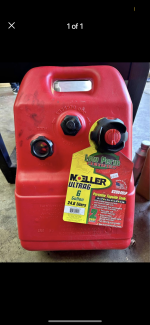

Sold all my other tanks today. Kept my Moeller 3 and bought this off marketplace. Thanks for all the help especially Jim
