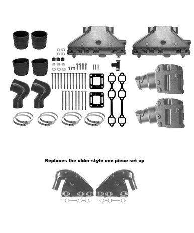

Is this one of the Merc 4.3s with the one piece exhaust manifolds (‘96-‘99), if so these are known for failure & leaking water back into the cyls. There are conversion kits to convert those to the conventional 2 piece style….

Lou C yes it is a one piece manifold and There is conversion kit can any of you tell me of a place i might find the pair from what i'm seeing it not going cheap.Welcome to the world of boating.

Merc makes an OEM kit, and Barr Marine makes an aftermarket kit, I have used Barr with good results on my OMC, which also had the one piece V6 exhaust although I never had water leaks from those, but they were NLA when it was time to replace them....
Here's a link to a place selling the Barr version....
Not cheap but it has everything you need to convert. No one except GLM made a kit for my engine (OMC) but due to GLMs lousy rep at that time (don't know if it's better now) I elected to put my own together from Barr Marine's OMC/Volvo manifold & elbow kit with additional OMC/Volvo parts needed to convert to the later style. And at the time I think the total cost was about $1200, but that was like 8 years ago. It all fit like factory with no leaks. The cost, well it is what it is. Bad marine exhaust has killed many inboard engines!

Well, this is good news that you found the issue. While I like to try to help, I am also trying to learn. I am a ‘lifelong learner’ as they say. As such I am not familiar with the one-piece manifold and riser so could you please post a picture of it? Also, I would be interested in the cylinder 6 hole > can u post a picture of that as well?

Thanks for the picture. Odd that hole did not hole did not rear its ugly head during the test run as it looks like it’s been there for a while. And Lou’s link had a picture of the older style ‘batwing’ so good there too.
