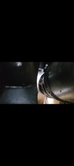

Hi, I am a new member and I'm not super great at terminology but I have a minor problem with my Volvo Penta 5.0FI. It's the original motor in a 1995 Wellcraft Eclipse 196S. There is water coming from a little hole in the middle of the exhaust piece just before it goes through the transom. I attached a little video I used to see where it was coming from. Is there a backflow valve that might be stuck a little open? Only leaks when the boat is in the water. Not on the muffs. It doesn't reach the engine or anything but I can't leave the boat in the water overnight for fear the bilge pump decides to quit. Any thoughts?

Sorry the video size was too big here's a photo.

Unfortunately you will have to pull the engine to and the drive. The “Y” pipe probably has a hole in it. It may be possible to have it repaired at a welding shop. You will also have to remove the exhaust bellows to remove the “Y” pipe.

Ayuh,..... Welcome Aboard,..... At some point, Volvo deleted the exhaust shutters,......
I don't agree with such, but,......
If yer's had shutters, 'n they failed, they can fall down into the y-pipe, wearin' a hole through the casting,.....
Whatever caused the hole in yer's, it can Not be pulled from the boat, 'n repaired or replaced, without pullin' the motor 1st,....

VP removed those flappers in 1999 AFAIK so yours probably had em. However the way they were installed (they just used the original OMC Cobra design, same parts etc) there were 2 holes in the top of the Y pipe on each side. There were two grommets on the holes and a pin that the flapper rides on. Even if the flapper melted from an overheat it is unlikely for the pin to come out. The flapper itself is rubber coated plastic and can melt if the exhaust over heats. While the flapper is unlikely to wear a hole in the pipe the pin could. Other causes are just corrosion or a failed oring between the transom mount & the Y pipe, these can fail due to corrosion in either the Y pipe or transom mount o ring channels.
Normally when the boat is running on land the exhaust water flows thru the Y pipe to the idle relief holes in the transom mount. However when the boat is in the water the level of water in the Y pipe (called the static water line) is pretty high in the Y pipe, usually as high as the bottom edge of the exhaust manifolds. It would seem odd to me that it would not leak at all with the boat in the water yet it leaks in land running on the water hose. I would double check ALL the hose clamps on the exhaust hoses because if any of these are loose it can leak from the hoses. Also check the PS cooler and water inlet hose on the rear of the engine. You might get lucky. I’d specifically be looking for a running leak ABOVE the static water line level…
