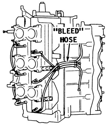

Anyone know of a diagram for the oil lines on the block ,. its not the oil pump lines its the smaller ones on the block to reed plate... I think I have them right but I want to double ck them anyway.. THanks JE
not at home, but I do at the shop,someplace.
its the same for all 2.6L carbed v6 motors.the intake ends are nipples,the block fittings are actually check valves and need to be tested periodically.
