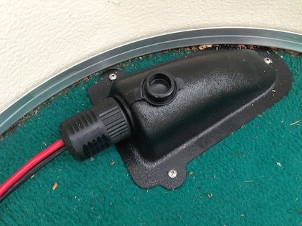

Thanks for the replies. Yesterday I was at Hallberg Marine in Wyoming, MN picking up some supplies and I happened to mention my 'problem" and how I could not find a source for the angled receptacle housing I'd seen in a pontoon picture somewhere on the 'net. Well, he said, "We have those in our pontoon shop." SO, 60 seconds and $20 later I had exactly what I wanted. For pontoon owners wanting a slick way to do the trolling motor plug connection, here is a photo of the housing as I am using it. Perhaps most any pontoon dealer could get these or you could contact Hallberg (Hallberg Marine - Boaters Paradise | Marine Sales, Service, Parts and Sports | Wyoming, MN).

I have the two group 27s inside the helm (that has an open end so there's plenty of ventilation). It's about a 72" 8 ga. wiring run to the plug. An onboard charger is mounted between the helm and railing.
