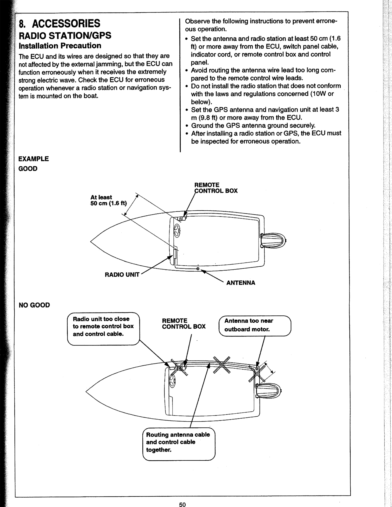

I just bought a new Honda 60 with a Tohatsu paint job and noticed in the rigging manual that you're not supposed to put a VHF radio, antenna, or antenna wire near to the engine controls and tachometer. I may not be able to get the recommended separation. What happens when a VHF component is too near to an ECU? And what is an ECU, anyway? Will the radio interfere with the engine/instruments, or will the instruments interfere with the radio, or both? What problem am I trying to prevent here and how serious is it?

I'm referring specifically to this page in the Tohatsu rigging and setup guide. It suggests that both radios and GPS units can interfere with the ECU.

Don't get it, you have a Honda, not a Tohatsu right ? If so, check Honda's tech specs about gadgets installations. ECU could be better shielded and not be affected so much as a Tohatsu ? Anyway, how far are you from ideal distance installation as per drawing ?

The drawing suggests installing the radio on the opposite side of the boat. Our is a pontoon boat with a side console and no other furniture of any kind. I don't want to just sit a VHF out on the open deck, so installing it in the console is the only option. The console is only two feet wide. There's no way to achieve anything like the recommended separation for the radio itself and its antenna wire will inevitably be in the cluster with tach wires, etc.

As always, the ECU is the Engine Control Unit (the computer). Review your owner's manual from http://www.tohatsu.com/tech_info/own...1-ZZ3-T000.pdf
Nothing there indicates an issue with vhf radios or GPS receivers.
There are No service bulletins for the 4-stroke 60's either.
Of course, it is always best to keep different RF-generating devices as far away from each other as reasonable.

You should be fine. The GPS signals are in the 3-GHz range; VHF is of course in the 150-MHz range. Although... I once had an old analog cell phone that would cause my FM stereo radio on the boat to mute when it was in use. Actually was quite a nice feature for the IF stage of the radio to go dead while on the phone... didn't need to adjust the volume during calls :)
