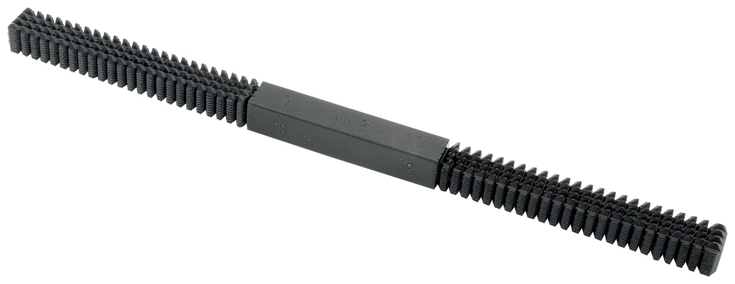

To clean up the threads in the housing, you're going to need a thread file, not a tap. A tap that size will be VERY expensive.

I have ordered the new bushing with seal and a new shaft. It wasn't very pretty once I got it out. They haven't arrived yet, The housing has survived OK. Just need to clean up the thread. I am guessing being US built it will be a UNF thread. About 15/16" I reckon. I understand about the thread file.
