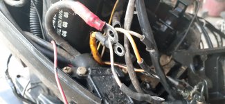

Well when u get a certain age they ought to make you stay in the house and not take anything apart. You c I took a carb off a 1986 35 HP merc electric start 2 weeks ago and forgot to take pictures and still waiting on carb kit and dont know where wires go where! Yeph dumb I no but that dont make me feel any better. My son just shakes his head and dont say anything, but his mother has to put her 2 cents in, U all know whAT I am talkin about Im sure. Well I need help and Im not real good with wiring schematic. But help, please. Ohio man in trouble, again.SEEMS I HAVE A BUNCH OF WIRES THAT GO SOME WHERE

What color are the wires? Merc uses a fairly standard wire color scheme.

I will take some pictures and give the colors in a few

fused red wire
creme
yellow
lt. brown
yellow, blk. stripe
big black
big yellow

Think the Red with fuse would go to the rectifier for charging te battery
They all appear to connect to the starter relay
