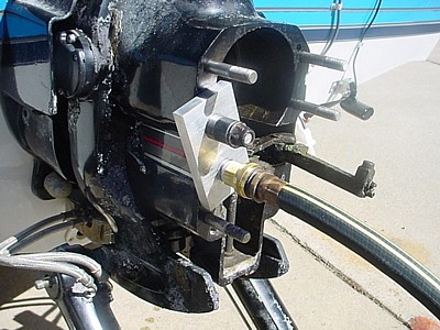

51,869
You can simply shove the garden hose into the cavity in the transom shield and use duct tape to secure.
here is the hole you shove the hose in
fetch
here is the tool if you want

Just to follow up on the 'flush' tool that Scott illustrated in Post #4, mine came today. It's nothing fancy, but definitely heavy duty. It's a 1/2" thick aluminum base, drilled and tapped with pro grade (as in, not Home Depot) brass fittings attached. The price was decent, but they charged $5. for handling and another $9. to ship it. Even at $49. all in, though, I think it's worth it.
