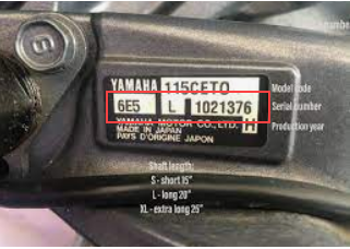

What is the primary ID of the motor?
Not sure what you mean with primary ID… 1986 90AET(L) as I wrote in my first post. 6H1 is the approval code. 1140 cc 3 cyl without autolube/precision blend.

6H1 is the first part of the PID. Then an L or and X. Then some numbers.

6H1 is the model prefix.

I am in the US. We don't have a your model over here. With the PID I can get to the US equivalent.

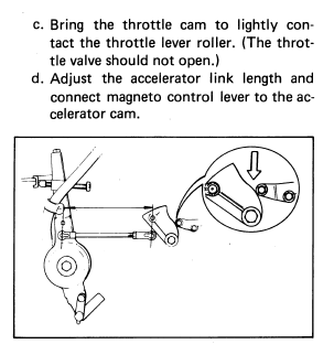

Y
Is this to what you refer?
Yes, seem to be like this on most carbed two strokes. But I had an Evinrude 70 some years back where there was maybe 5-6 mm gap and the cam should touch the roller at a specific timing value.
