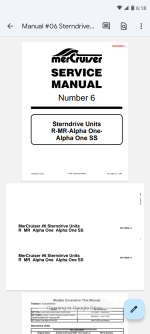

Just to be clear...this is the correct manual?

achris
More fish than mountain goat
May 19, 2004
27,468
That's the correct manual. The upper driveshaft has shim heights and preloads to be set, and the drive gear bearing pack also needs to be shimmed to the correct depth. The shims adjust the bearings and gears to the housing, so changing the housing means you MUST set the shims. Without setting up the shims correctly, the drive life is measured in minutes, not years.
Read through the manual (at least 3 times) before you start the job. ANY questions or doubts, ask here. Easier to answer a silly question than reverse a stupid f...up.
Chris.....
