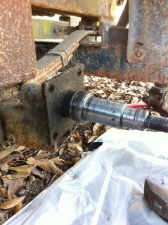

1. The bearings... I'm guessing it must have a 3500lb axle because it has a tapered shaft with the 1 3/8" & 1 1/16" bearings. The hub is the kind that doesn't have the studs, but just threaded holes and it uses lug bolts to hold the tire on. I already have the bearings off one side. My question is should I just replace these bearings and the inside seal, or should I just buy a new-style hub (that has studs) that already comes with the bearings in it? Bearings are around $15/each and hubs are $35/each. In the pic below of the axle, are axles even made like this, where the spindle is welded onto a piece of square tube? Or is this a home-made axle?? Should I replace the whole thing??
Also, I've found 3500# axle bearing kits at TSC and Academy sports, but the numbers on them don't match the numbers on the bearings I took out. Does it matter as long as it has 1 3/8 & 1 1/16 bearings?

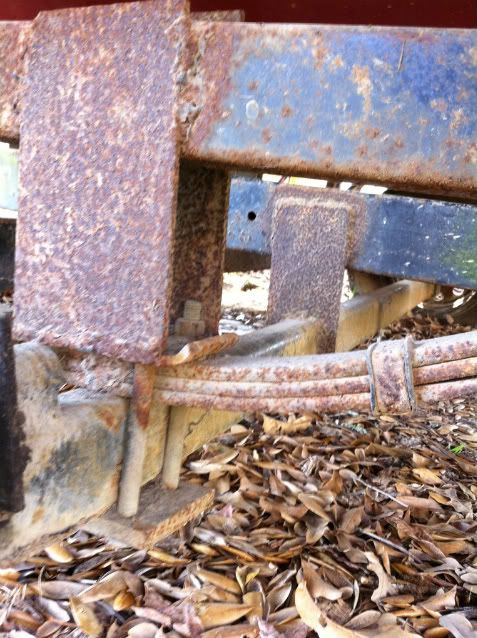

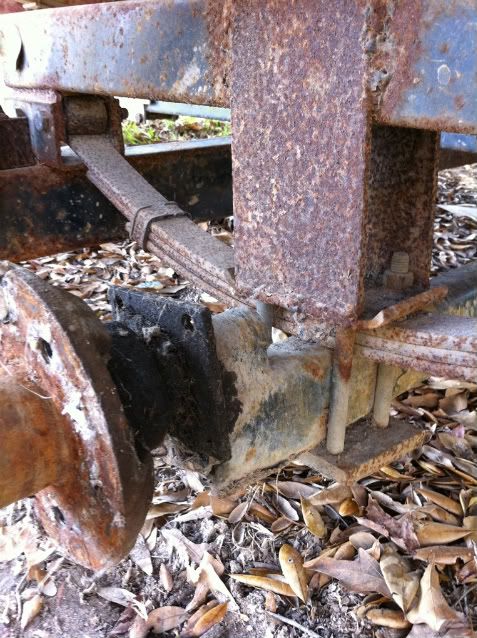

2. Upon inspection of the trailer, I noticed that a piece of flat bar has been welded from the axle to the frame! Only one reason why someone would do that, so I get to looking and sure enough the leaf springs have broken on one side of the trailer, right in the center under the axle. So they welded the axle right to the trailer frame, bypassing the spring and surely giving the boat a rough as heck ride down the highway. So, should I just replace the springs on this side (is that possible?) or leave it as it is? In this picture you can see the 3 pieces of metal welded on...

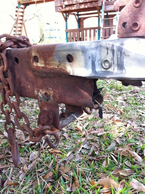

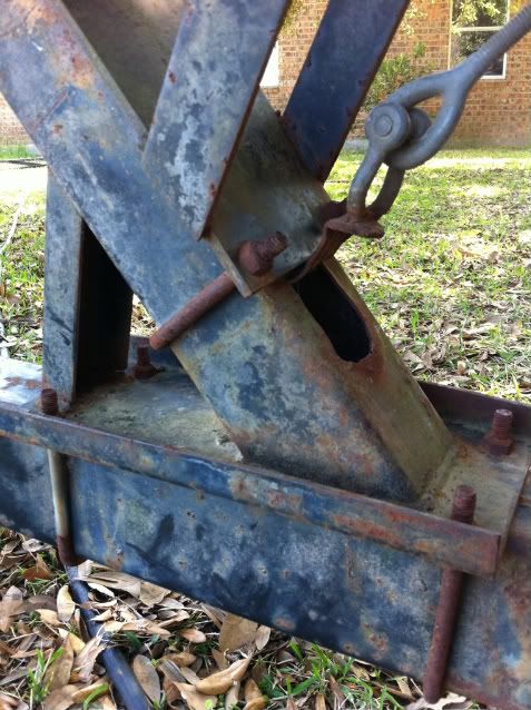

3. What do you guys think about the front of the trailer... the tongue, emergency chains, winch tower? Rusty... can I wire wheel the rust and paint it? Or does it looks more serious? The tongue lock seems to work still.. See how the bow eye tie-down on the tower looks like it was either home-made or like it is pulling away from the tower? What should I do about that? The old winch still works good and it's a two-speed winch so I might keep it.

time for a new trailer. seriously. To undo all the stuff the previous owner did and get it right will cost you near what a decent used trailer costs.
I'd be very afraid of those welds, especially if it's a salt water trailer.
The PO's welding a block to cancel out the springs, instead of the cheap and easy replacement, speaks volumes. Your boat and the lives of the people behind you (and all around you, and you!) are depending on his skills and care.

Look for a new used one! Seriously that trailer has been butchered. How big is this boat? How far do you have to go? Personally I would not use that trailer. Springs, axle, coupler all have issues that need to be addressed before I would even think about taking that thing on the road, even w/o a boat on it. That's not even concidering the lights.

That trailer is DONE! Don't put a dime in it! Your bow support is particularly telling as the material where it pulled and rotted away shows that there's been a terriffic amount of corrosion inside the frame. The springs are obviously junk, the coupler looks like it's welded to nothing anymore, I wouldn't trust a weld on that thing at this point.

I have to agree as well, that thing has been hackity hacked and bad. The axle for sure needs to be replaced. People do make custom axles with square tubing! However I have yet to see one welded like that and looking at the welds on the vertical plates holding the axle to the frame does not instill a lot of confidence in this persons welding abilities. Also did that thing have brakes? The other issue is given the amount of rust showing up I would be worried that the trailer is rotting from the inside out. Go find a different one and chop up this one for scraps (and a good winch)

I am a Highway Enforcement Officer and a Certified Vehicle Inspector.....if I saw this on the road in my jurisdiction the trailer would be parked , placed out of service and you would have to get a flatbed to come and take it away.....need I say more. The field welding as we call it is enough to place it out of service. Dont risk your life or others on the road with this please!!!! I have investigated enough accidents caused by junk like this and i`m sure my compatriats in your neck of the woods feel likewise.

Yup, it's junk. Hard to say the axle rating as it looks like a piece of square tube with the hubs welded to the top. I'd get the wheels on it and call a scrap yard to come get it. You'd probably get $50 out of the deal. That way you'd know you won't meet it on the road some day! Keep in mind that used trailer values seem to go down if there is a boat on them. So you may look at some junk boats on good trailers and find a steal.
