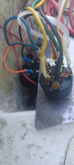

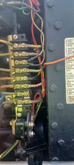

I have a 1988, 125hp Force outboard. Don't know any history on it, other then it sat for years. Had no key for the ignition switch when I bought it and purchased a new ignition switch online. Had it fire up briefly before I installed the new igniton by jumping the solenoid. On a side note, the boat was junk, so I disconnected all of the wires at the dash and pulled them back to the motor and hooked up the new ignition switch. Never had spark again. Read over forums and saw that I should disconnect the white wire for the stop switch, where it mounts to the wiring block. Did so and the motor started. I had to touch that white wire to it's terminal to shut off the motor. The other end of that white wire goes directly to a terminal on the back of the ignition switch, there is no stop switch in-between. A wiring diagram from Master Tech, shows some sort of stop switch, but I don't believe I have one. Doesn't the ignition switch act as the stop switch? I also see that there are 4 different ignition switches listed for this motor. Perhaps I bought the wrong one or have it wired wrong? There is no kill switch near the shift control handle. Any thoughts or ideas are appreciated.

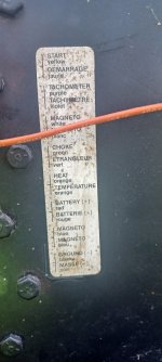

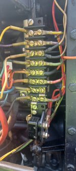

The blue wire from the other M terminal at keyswitch should go back to the terminal strip at the engine and be connected at the second screw from bottom.
There should be a metal jumper between the second screw and the first screw from bottom at the strip and the first screw is for mounting the terminal strip to the block, soo it is ground.
If the jumper is gone connect the blue wire to first screw or make a jumper from a wire and connect between first and second screw.

The blue wire at the terminal strip is grounded as you described. At the back of the igntition switch, the blue wire is grounded when the key is in both the off position and on position. The white wire at the ignition switch is grounded when the key is in the off position but not the on position. When cranking the motor, the white wire is grounded, and I believe that is the issue as to why it won't start with that wire hooked up

At the back of the ignition switch, I moved the blue and white wires to each other's terminal, thinking that could be a different position of contact when starting but the results were the same. I greatly appreciate your help

The issue is that you have the black wire connected at the I terminal at the keyswitch.
Remove it and isolate it at the terminal pad.
No ground (minus) wire should be at the keyswitch.

Yes sir, that was the problem! I deeply appreciate your help. Thank you so much for taking the time to help me. I will pay it forward.
