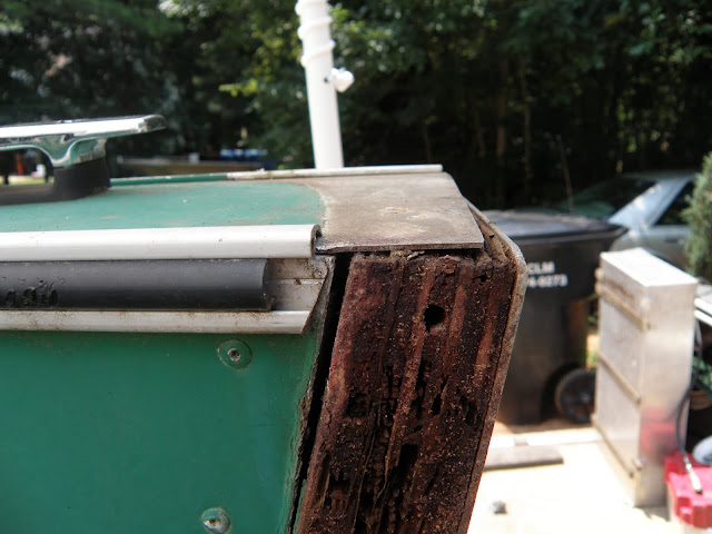

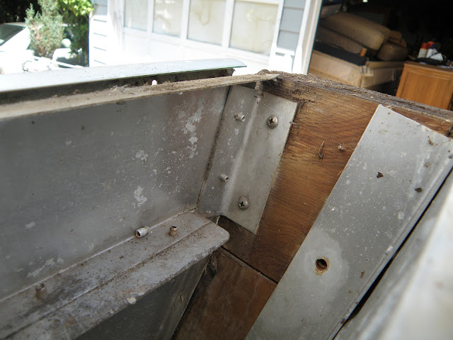

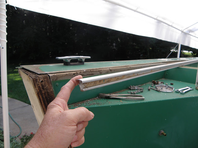

OK here goes well the first thing I did was to slide the rubber out of the outer rub rails, then once that is done I removed some of the screws from the outer rub rails starting at the transom working towards the bowONLY REMOVE ENOUGH TO MOVE THE CHANNEL THAT HOLDS THE RUBBER AWAY FROM THE TRANSOM AREA WITH OUT PUTTING A BEND IN IT. Then once that is done remove the rubber from the inner rub rail just far enough towards the bow to remove the rivets from it to move it out away from the transom with out putting a bend in it. Then once these to pieces of channel are loose you will see the rivets on top of the gunwale that holds it down remove enough rivets from it to lift it up high enough to remove the wood from transom without putting a bend in it. That should pretty much do it. you can see some pics of this in the link below in my signature the one that points to picasaweb I may revive this as I go if I find a better way to explain or anyone has trouble following this.

Thanks Jim now lets see if I can get the pictures up to go with your tutorial.
Ok theres the pictures to go with Jims Tutorial.
